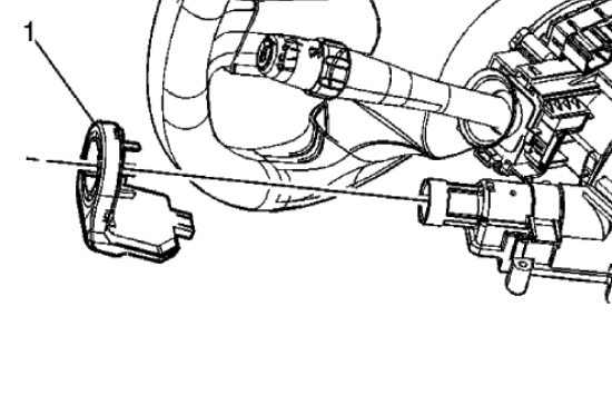

Why didn't you just go to a GM dealer parts department and get a new key cut to your VIN? Some locksmiths can do it.
This is the warning that comes with the 30 minute procedure:
#1 is the PK3 module, otherwise known as the theft deterrent module (TDM).
