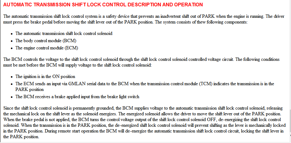

I will give it a try on Monday, but I don't think this is the issue. I pulled the shifter and inspected the lever and it did come up and close the switch. I also shorted the two wire on the switch to make sure it was not a bad switch. No luck there either. Went back and checked all the fuses in both fuse boxes, and they all looked good. Kind of at a loss of what to do next. At one point in time I did get an ignition switch error, but that was back when I was getting 4-5 errors, so I didn't record it.

Okay, stupid question: On the ignition switch, the first detent appears to be accessory. When it is turned to this setting nothing comes on. No radio, nothing. Is this correct?
From the schematic it appears that the power to the shift lock comes from the accessory setting on the ignition switch. So my guess is that there is a fuse somewhere that I have not found or that the ignition switch has gone bad.
