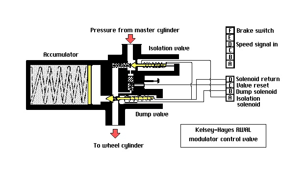

The abs valve module can definitely cause a low brake pedal. I have came across three of them so far causing a low pedal.
It's not common but it happens.
Inside the vale module are accumulators that take the pedal pressure in and abs stop and with a pump can lower or increase brake pressure to keep the wheel from locking up but still apply ample pressure to stop the car.
If one of the valve that would be normally closed to an accumulator is stuck open or not sealing the brake fluid would have to fill the accumulator before brake pressure would apply the brakes. Giving you a low pedal.
In the diagram of a non abs stop if the dump valve did not seat properly the pressure would be lost to the accumulator until it's full.
