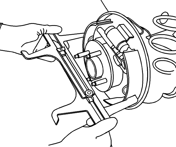

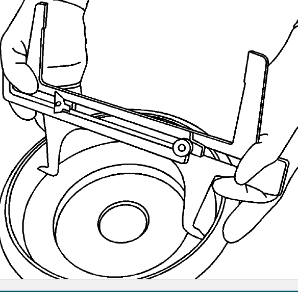

If any tech in a shop looked up on the peg board behind the brake lathe and the shoe trimmer they would see the correct tool for adjusting drum brakes.
First you measure the I.D. of the drum, then use the other side to set the width of the shoes. The tool is usually preset for the proper clearance.
