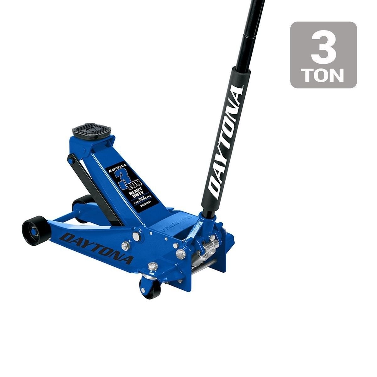

X2, use a Johnson bar and piece of pipe or floor jack handle.
floor jack handle is handy ,if you have one
Piece of pipe for extra leverage
