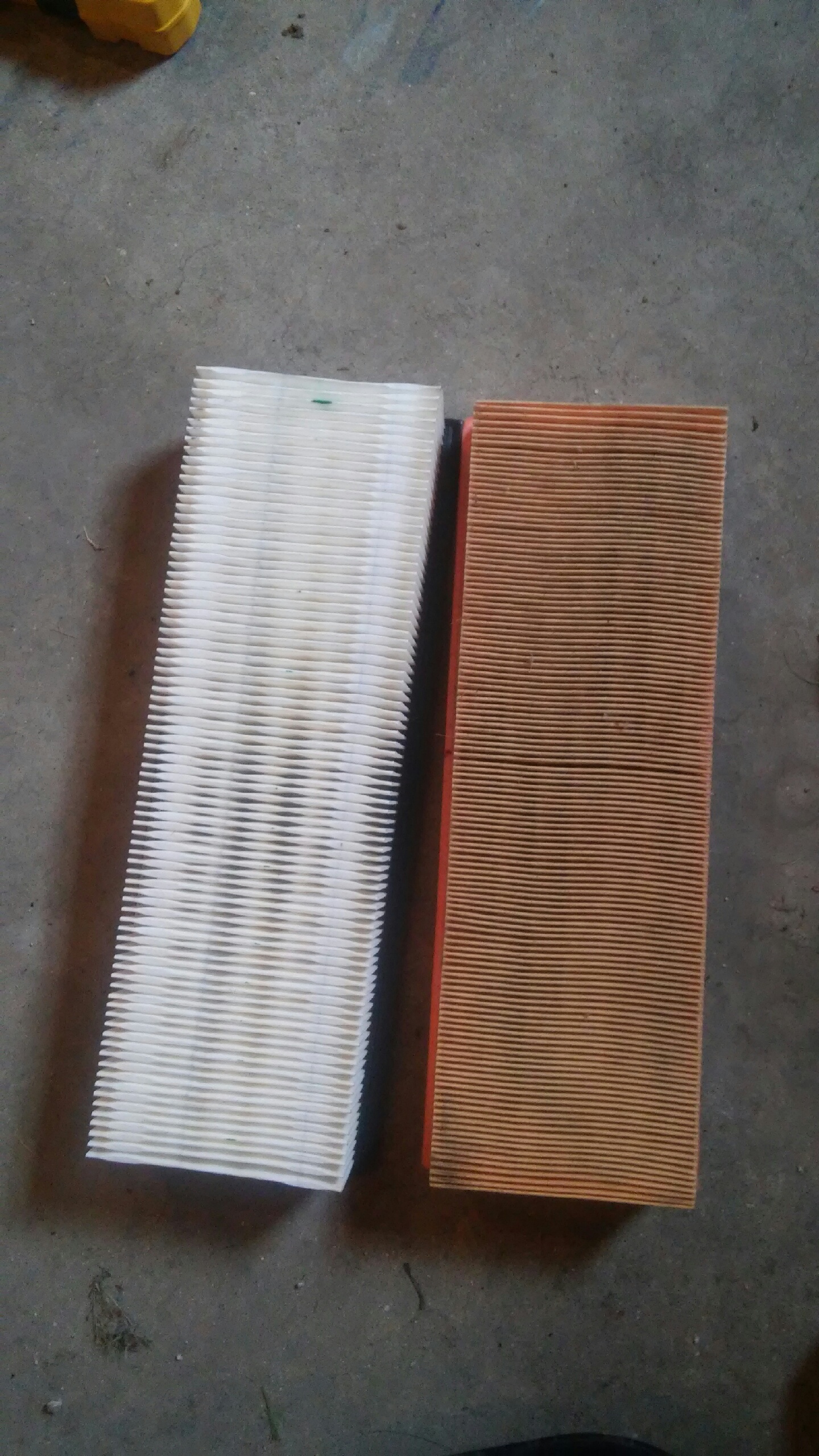

Hello all,
I am trying to figure out why my MPGs have benn going downhill the last couple months, the air filter could be part of it. But i took the ol' girl to autozone the other day because of a check engine light, they told me the code was P0128 which is the coolant temperature sensor. Could this be affecting my mileage as well? Also going along with that sensor could this be making my fan run all the time as well?
Thanks!
