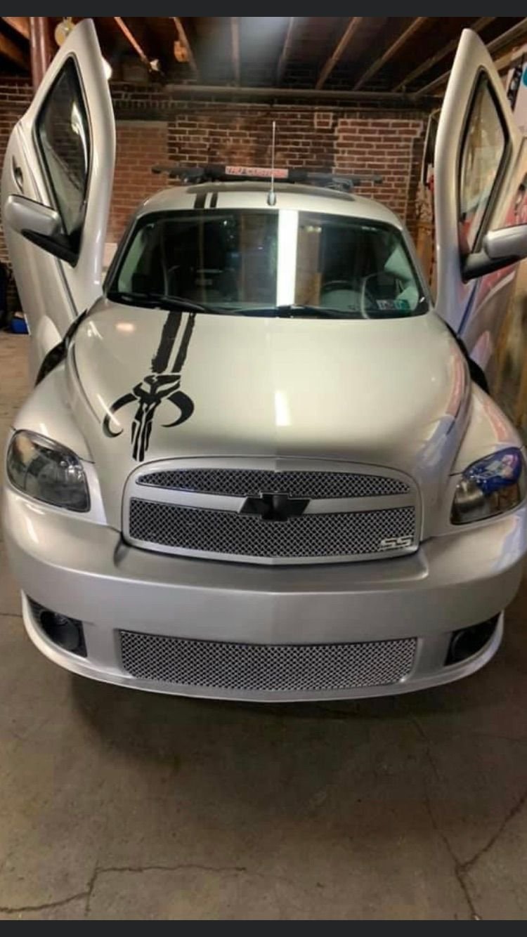

My 2008 hhr ss overheats , I changed thermostat it makes a loud whirring noise when I accelerate/push on the gas. Looking for suggestions on what it could be. Thanks

I have a 2008 zzp edition HHR SS. It’s overheating and makes a loud whirring noise when you step on the throttle. I was told it’s pbly just an air pocket in my coolant system , but I figured I’d get a second opinion just in case. I’ve already changed the thermostat twice with no change in the problem. Please help me with this, I love my car and need it on the road where it belongs lol
