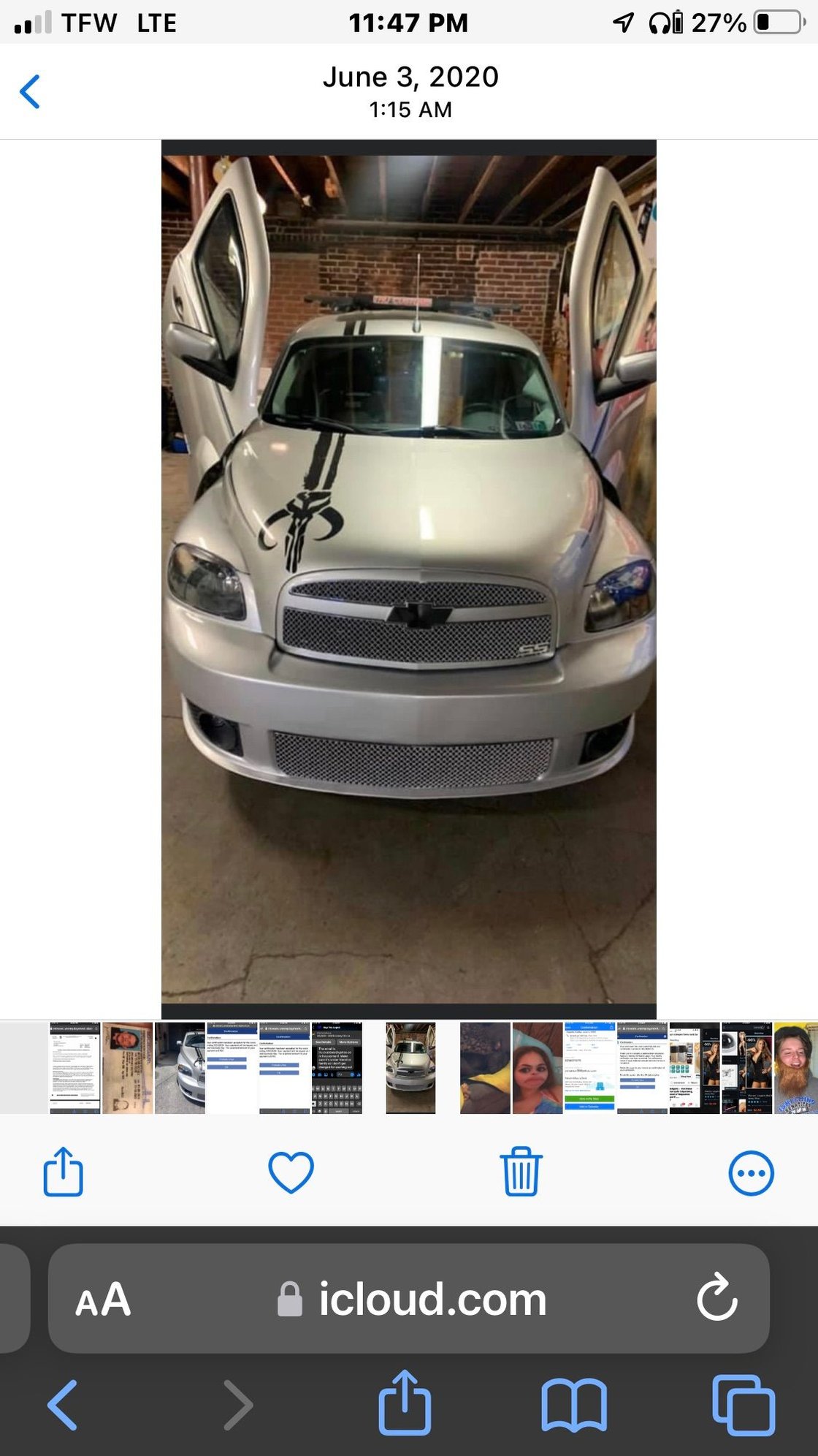

Need help urgently please please please
Troubleshooting, looking for ideas and advice My 2008 HHR SS Is overheating, I checked the top radiator hose and it’s not solid so it’s not the head gasket . What other things could be causing this problem ?? I replaced the thermostat 3 times once with a regular one then again when the performance one it came with came in. And changed it again because it didn’t fix the problem figures maybe it was a defective one but the newest one didn’t fix it either. Going to just take the thermostat out now and run it to see if it changes anything. Then I was gonna try the water pump. Anybody have some other ideas. I need it fixed . I love my car and need it back on the road ASAP.
This is my badass baby , please help
