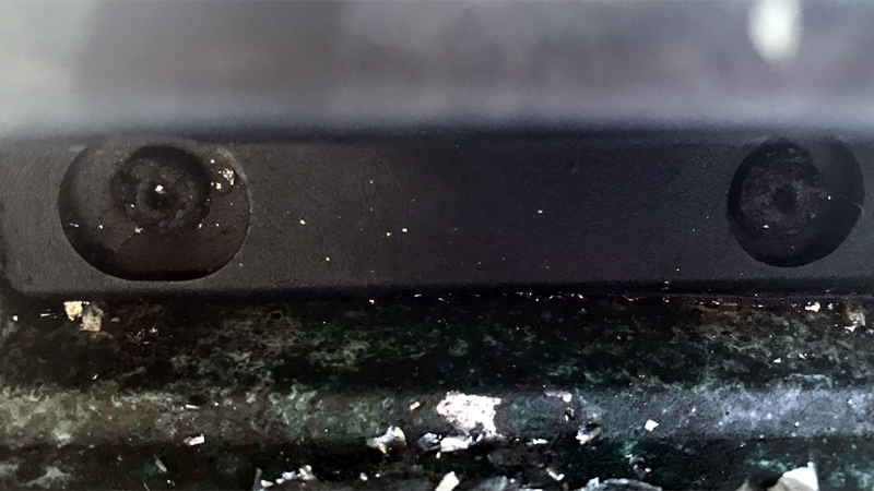

The bottom of the latch, looking at it from the outside, has two screws - of some kind - that are very rusted. I can't tell if they're torx, or whatever - I took a pic which I'll try to attach. if those have to be "un-screwed", whew....I dunno.

Hey, I appreciate the links to the manuals - think you misunderstood. I know you can look at a fuse (almost always) and tell if it's alright. I just couldn't figure which fuse was #10. I'm gonna get the trim off inside, and, I'm thinking the thing should be self explanatory, to some extent. Mostly I'm worried about those screws, or whatever they are, on the bottom of that latch unit. I'll post an update when I get into the thing - I took a chance and ordered the replacement part......hope that's what the heck is wrong.

They are plastic rivets, just pop out with coercion.
