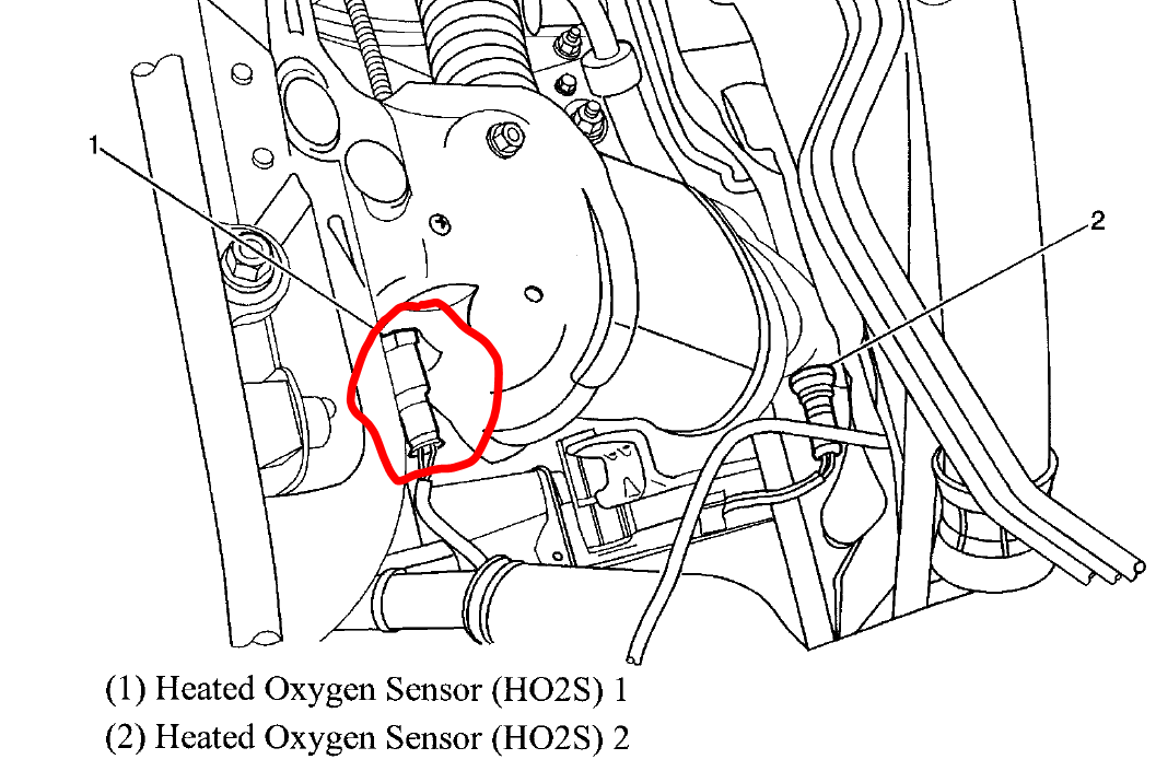

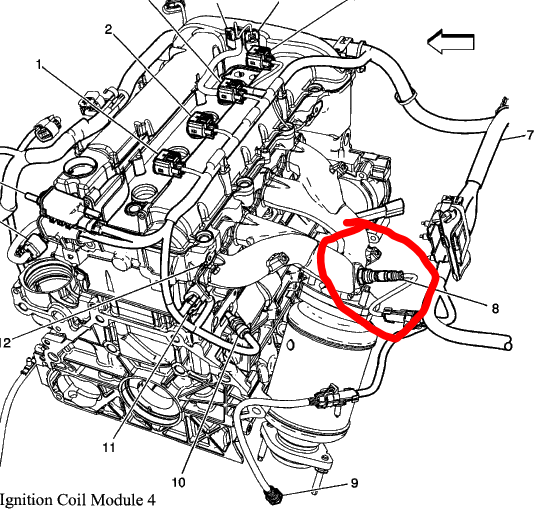

Some 2006 cars have the O2 sensor bung on the manifold other years have it on the pipe. You should be able to see it from the top either way. If it's on the pipe you may be able to replace it in situ, actually easier to take the pipe out. The locks on the electrical connections are challenging.
One member managed to detach his bicep trying to do it in the car.
The problem could be the wires are laying on the exhaust.
Neither of these look exactly like I remember, but close enough.

That boot is crumpled because your wheels are not pointed to the left. Rack & pinion. Normal. That is what tie rod ends are for.
The circled bit is supposed to be where the hose clamp is. The clamp is OK.
Attachment 21118
