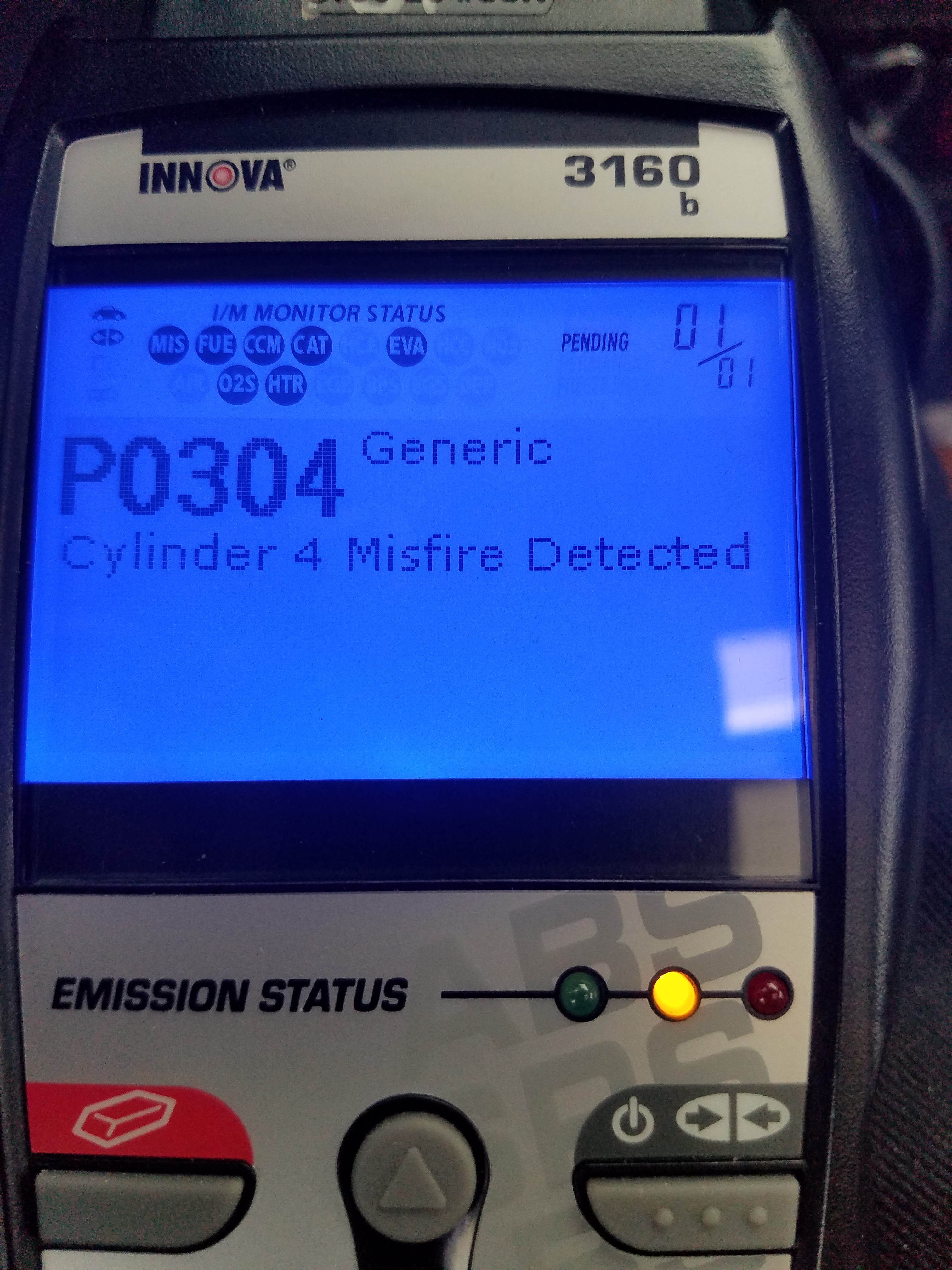

Well, I finally switched my number 1 and number 4 injector, and guess what? The new code I get is P0304. I feel pretty certain that I need to get new injectors
