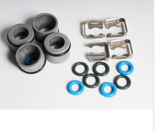

What is the seal kit? The photo shows the blue o ring on the injectors. Is there another seal I need besides that and the black o rings on each end?

The injectors come with their seals, these are the "installation" seals. My cups were all carboned up and not reuasable; I had to use a lot of force to get them out. Then scrape the carbon off of the head.
Fuel Injector Seal Kit ACDelco GM Original Equipment 217-2257 | eBay

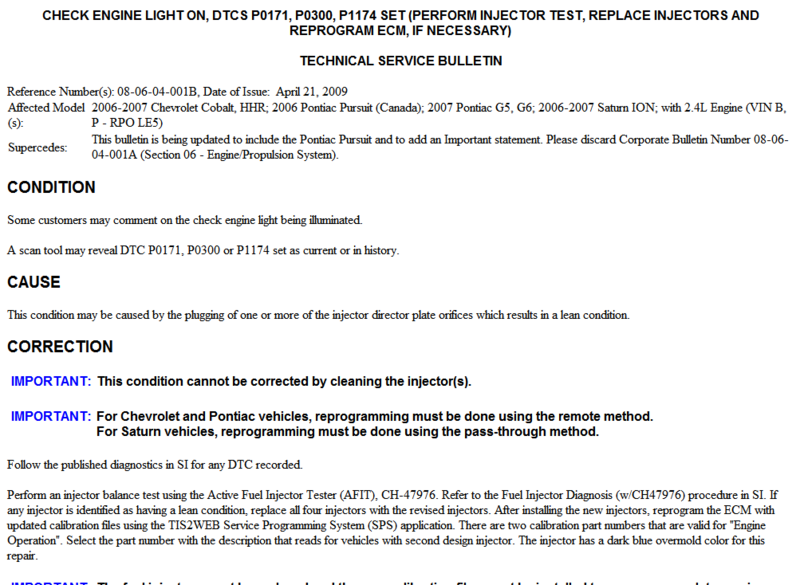

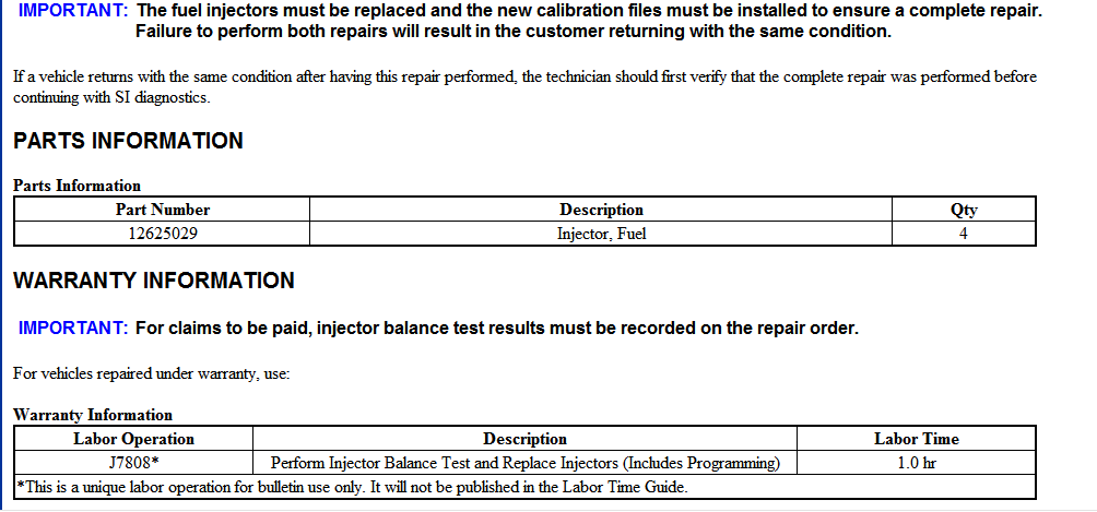

Here is a TSB on the subject. There are a couple others, but the symptoms should have manifested a long time ago (like when it was new).
The thing is there are 2 designs of the injectors, the ECM needs to be programmed for the correct one, it is preferable to have the second design with the appropriate program change. Sorry, I can't find the relative part numbers. I guess get the number off yours and compare to what the GM book says. I am taking a wild guess that you have the "old" design, so you will probably need a reprogram.

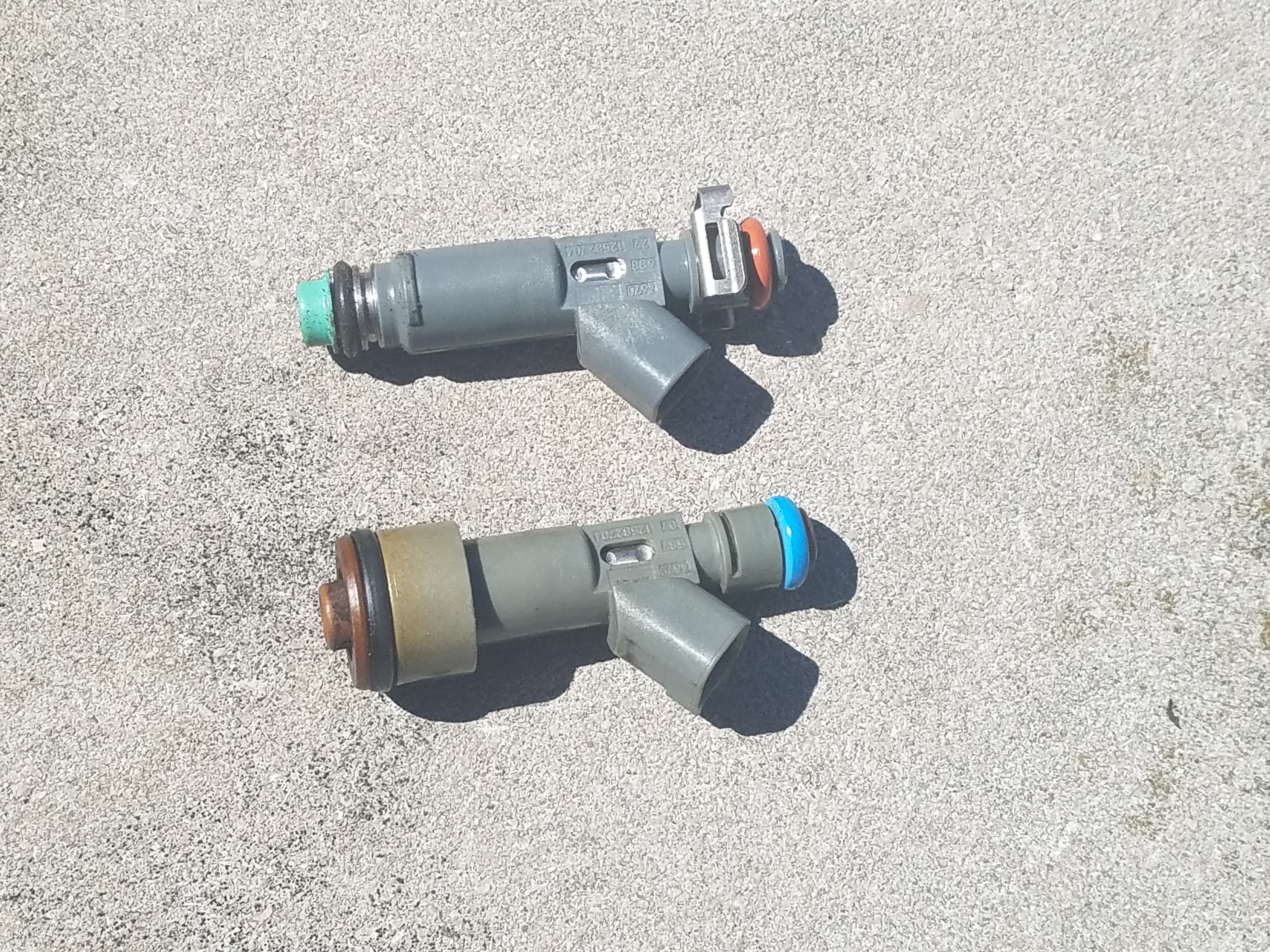

New injectors arrived, and they looked different. Took me a while before I figured out that I just had to remove the sleeve from the old and put it on the new. Car is idling smooth again, and running strong. About 20 miles, and no misfire code or P0171 code. And, amazingly, no TC or ABS codes either. This is why I hate computers in cars so much. You can never tell how one thing controls another thing.
Attached Thumbnails Need to repair codes so I can pass inspection-injectors.jpg
