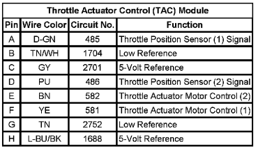

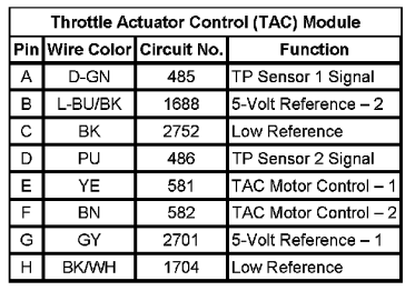

The electronics in the TB are a bit complicated. That could be it, shorting something.
I could get the connector pinouts if needed. But, note the colors and pins are different here.
This is for 2007 HHR 2.4L.___________________________ This is a 2007 Cobalt SS

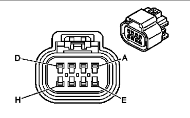

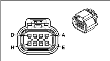

I've been looking around a bit. Seems 2007 HHR 2.4L is the same 8 pin connector as a 2007 Cobalt SS 2.0L. The 2.2L HHR is 6 pin.
There wasn't a Cobalt in 2004, Who would want to SC a Cavalier?
pinouts
Cobalt on top HHR on bottom

The adapter. That's why I went to the trouble of posting the pin assignments. You might look at the wires and make sure they go to the correct pins on the TB.
The connectors are the same, the pinouts are different.
