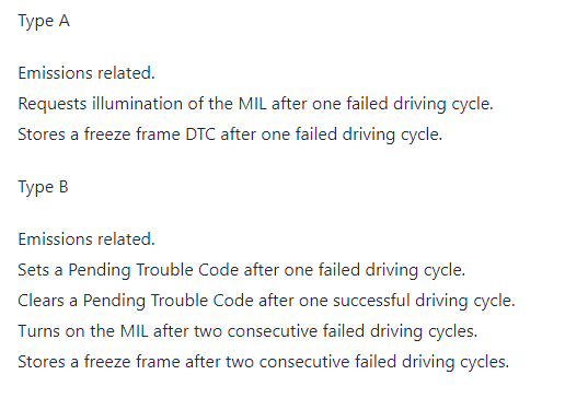

historic code doesn't mean anything and does not light the CEL. Only a current code will light the CEL.
Historic means that it caused a CEL sometime in the last 99 cold starts. Pending means it has failed the test but, not as many times as it takes to become Current.
P0300 means "misfire detected, have not identified which cylinder, and might cause the cat to overheat or otherwise cause unacceptable emissions", it does not mean whatever nonsense your scanner "says", usually something like "random misfires" or "misfires on all cylinders".
There are 2 types of codes, P304 is type B. MIL = CEL.
You might check the connector and wires to the crankshaft sensor. If the crankshaft sensor or the ECM has ever been replaced the crankshaft sensor variation MUST be relearned, that is how a misfire is detected.
Vibration in the engine can cause the code, probably why the AC is preventing it. Look at the motor and trans mounts. If you look through the oblong hole in the passenger side wheel house and don't see a bolt head centered the motor mount is bad. Has the harmonic balancer ever been off, maybe not torqued causing vibration. Has the balance chain ever been mucked with, the alignment is important.
