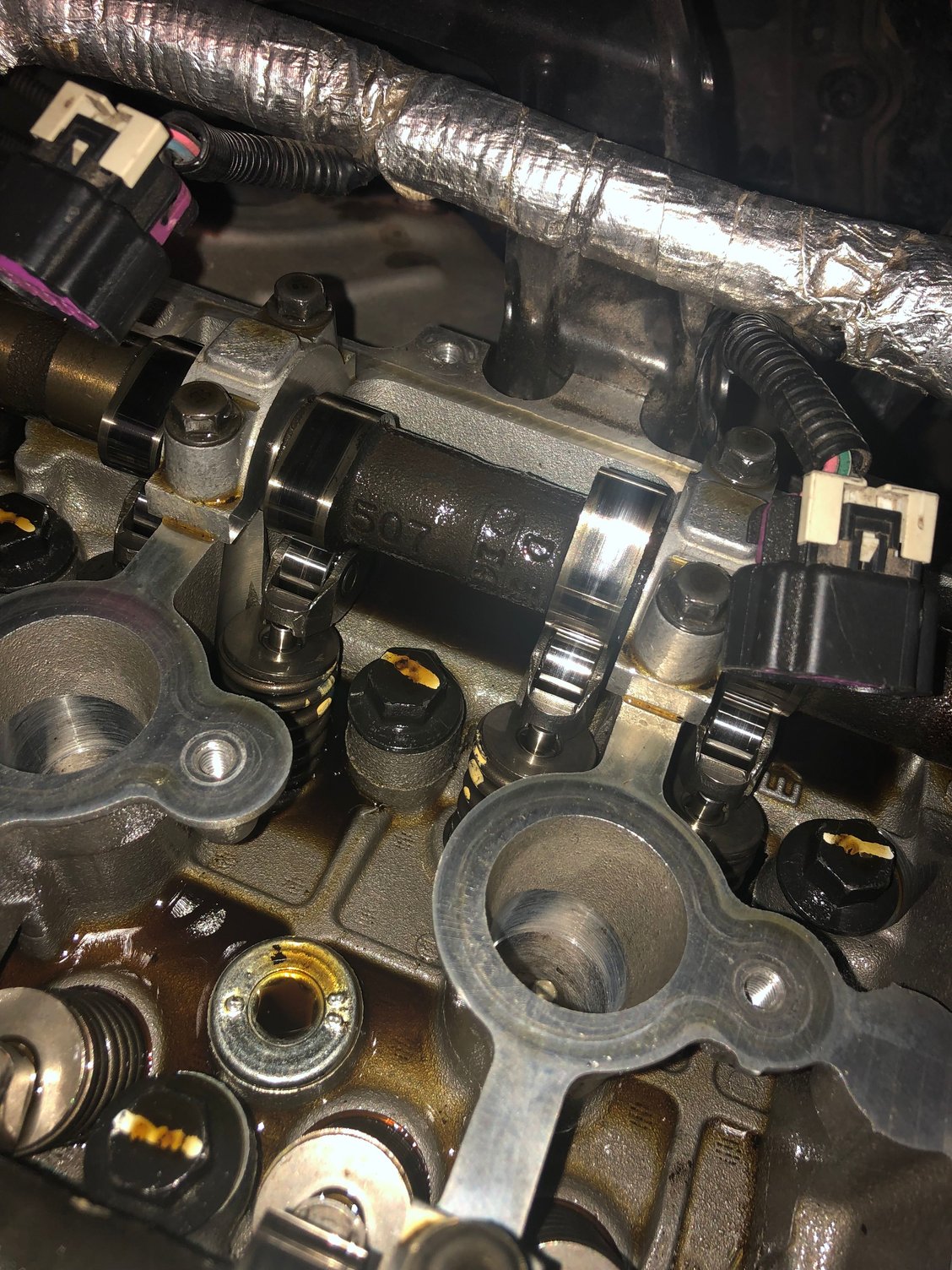

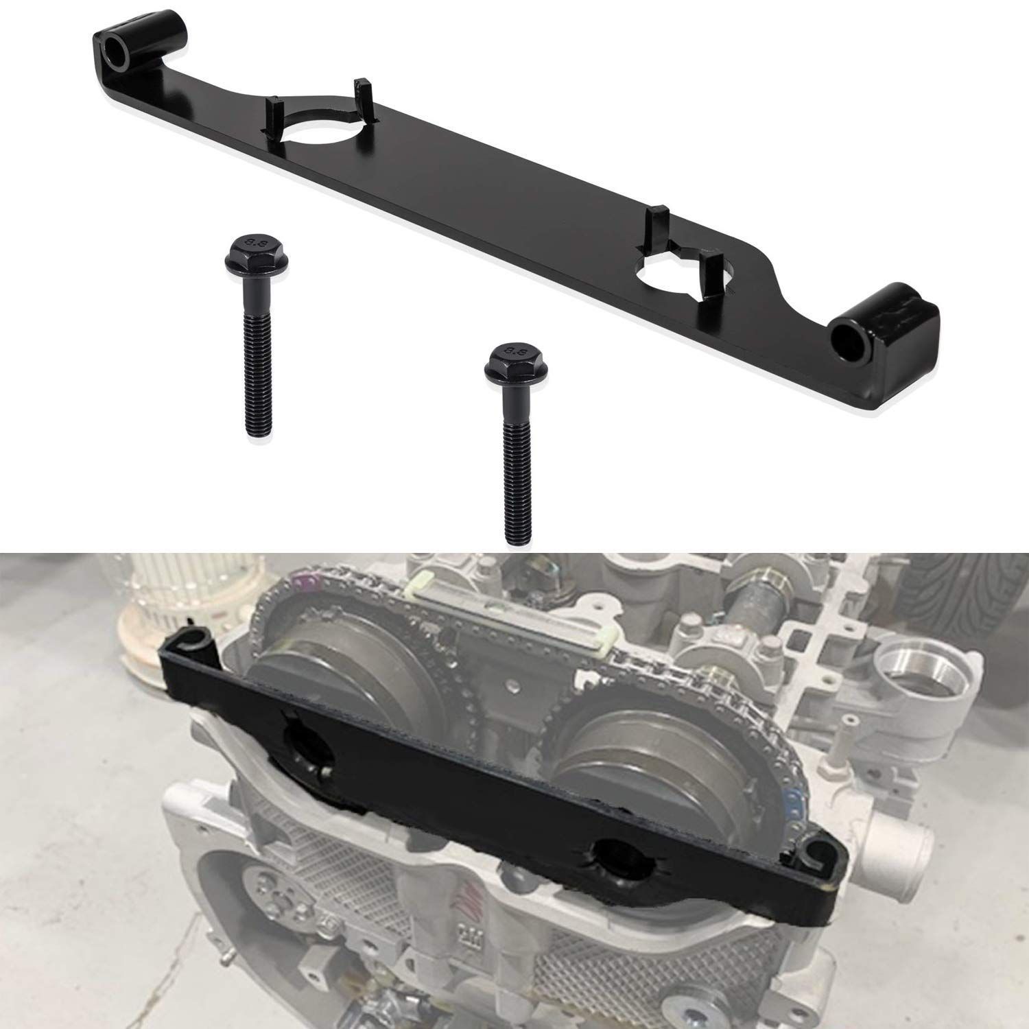

If you support the timing chain sprocket, you might be able to, however the phaser doesn’t have anywhere to hood it .
there are tools available to hold it , but very expensive.
the valve springs are visible from the top with the valve cover removed.
do not turn the crankshaft counter clockwise ever!
slowly rotate the crankshaft and observe the springs, look for damage around the camshaft follower’s
Phaser holder tool
A view of the valve springs and cam followers

I tried this, got the special tool. The problem is that the phaser slides over the end of the camshaft. So even though the phaser was held in place, the camshaft would not come out. So I modified the tool, hoping to have enough space for the phaser to wiggle off the end of the camshaft. Still couldn't do it, and then the phaser slipped and I had to retime the engine anyway.
So, no.
