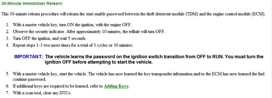

This is a GM dealership?
This procedure might work: Same as RJ just looks different.
Attachment 45506
Those are the steps that I am taking. I am in the car now trying to re do it but now 5 minutes into letting the key sit my car started flickering and now my car is dead and the key is stuck! It keeps getting worse

OK you need to get your battery charged and tested, you might need a new battery. Newer vehicles like this are very finicky, they need the voltage that they need. Weak batteries can cause all kinds of error codes and problems, even though they may be strong enough to turn the engine over.
The procedure for removing a stuck key is in the owner manual.
