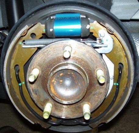

SLEEPER...when i first bought it(32k miles) and drove it for a few weeks I noticed the rear brakes were out of adjustment when i gave it a good "once over". I adjusted them(love the anodized wheel cylinders). 15k miles later, front rotors were warped.
swapped them for new(sadly pads were still almost brand new, but I pitched them too). I re-adjusted the rear brakes and wondered how they could be so far out of adjustment in such a short time. Only good news was, they weren't wearing.
another 15k miles and the rotors warped again and the rears were out of adjustment. we're talking 4 months, BTW.
at this point I am thinking I need to adjust them ever month just to try to save the front rotors, but it also seems like it doesn't matter since I kept after them, and yet the front rotors STILL warped, so....
but thanks for the heads-up.
Smoke Wagon-
Maybe the self adjuster arm is not locking the pinwheel after adjustment & they are backing off.. Cause many here & me are having much better results..
I check adjustment every tire rotation, or if my E-Brake needs more than 2 -3 clicks to hold the truck from rolling down a slope.
Just sayin..
PS: Congrats on the new job !!
Just sayin..
