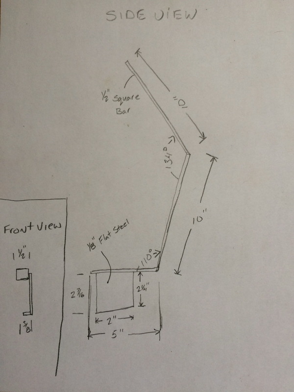

Could you provide a dimensional drawing, for those of us who would like to make our own.

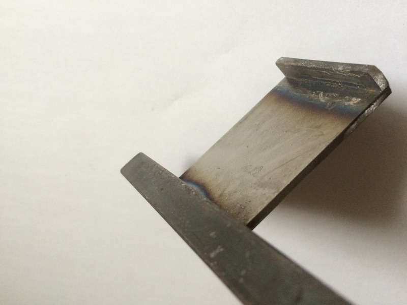

Here you go, a pencil drawing and one more pic to show the step to grab the bottom of the tensioner arm on the back side. You don't really need the top 10" section, I just figured I already had it and it gives a great leverage advantage.
Any questions, ask and I'll do my best to explain.

This pic shows the step I welded to grab the tensioner from the underside.
