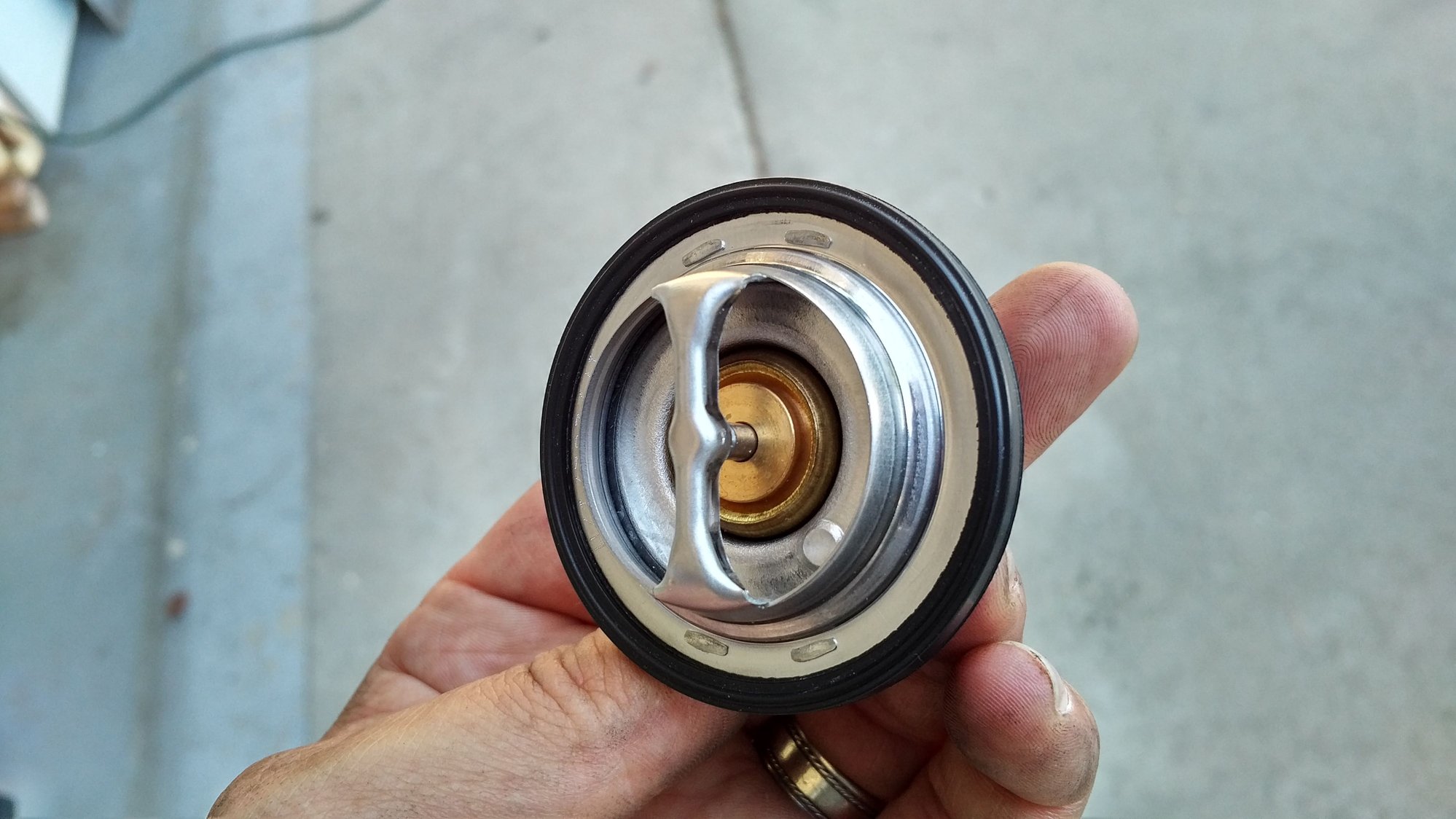

I pulled the thermostat out on Sunday:
Note the gap where the light goes through. I think that was a minor problem that was going to grow into a bigger one.
On the back side it's clearly visible how the rubber started to come out. Interestingly it didn't feel like it was deteriorating. It was just torn and started to slide out of place.
This picture is more interesting. You can see the shiny spot on the copper chamber that holds the gas. it was rubbing on the housing. I wonder if it got stuck there.
The new one I got from the dealer. After taxes it was $81!! But it came with a 5 year warranty.
Turns out the one that was in my car was an aftermarket one with STC stamped on it. It was also installed wrong. The seal was put under the thermostat instead of over the edge like in the next picture. So I most likely had a small leak there. I was loosing coolant slowly so now I'll see if it stops.
BTW The GM one looks a bit more robust and the rubber seal on the valve is a lot smaller.

That is the aforementioned inner rubber gasket that always fails on the wrong t-stat!
The 131-158 is metal to metal, no point of failure.
I wish people would start listening to us "old farts".
The t-stat has nothing to do with the motor running cooler; as I have tried to make clear it's job is to keep the temp ABOVE 180F and to get it there QUICKLY from a cold start.

You’re welcome, ( I so want to say, “Told Ya”) but yupp it was the thermostat! Glad you listened and found that gasket issue and the flap problem and the rubbing shiny copper thingy.
