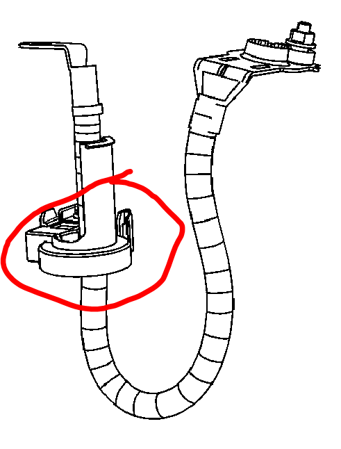

I am betting on a loose wire somewhere. You need to find out if the alternator is putting out and just not getting to the battery, or if it is not functioning for some reason. Like the control wires are broken.
All of the ground locations under the hood. https://www.chevyhhr.net/forums/how-...cations-56504/
You might check fuse #16 on the BCM.
Did somebody throw the current sensor near the battery away, thinking it was just a piece of extra stuff? It is on the negative cable at the battery.
Size:  18.6 KB No power on my alternator-charging.png Name:  battneg.PNG
