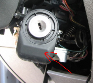

That bit that surrounds the key cylinder is the anti-theft module.
I think you may have jiggled a wire.

I did a 45m battery disconnect, and went in and triple checked the harness that plugs into that thing, still same situation. I looked inside that lil control module, everything there seems to be ok, do they just go all the way out sometimes?
If so, can I just replace it with another, or since it's a security thing will it be VIN-specific? There's a donor Cobalt just up the street I could pull from (if I can figure out how to remove).

If it was working correctly before you replaced that switch, then I would suspect you bumped, disturbed or knocked something loose.
It would be pretty unlikely that the theft module would decide to go bad exactly at the time you were working around it.

The fact that it is on is what makes me think you jiggled something around the key cylinder making the car think its been stolen.

Still can't find any loose wires or harnesses, looked everywhere inside the steering column.
