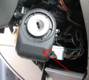

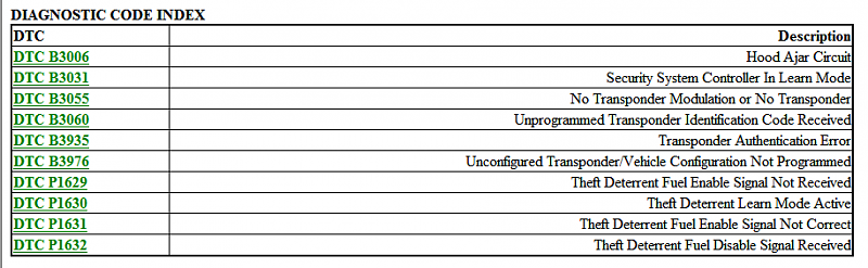

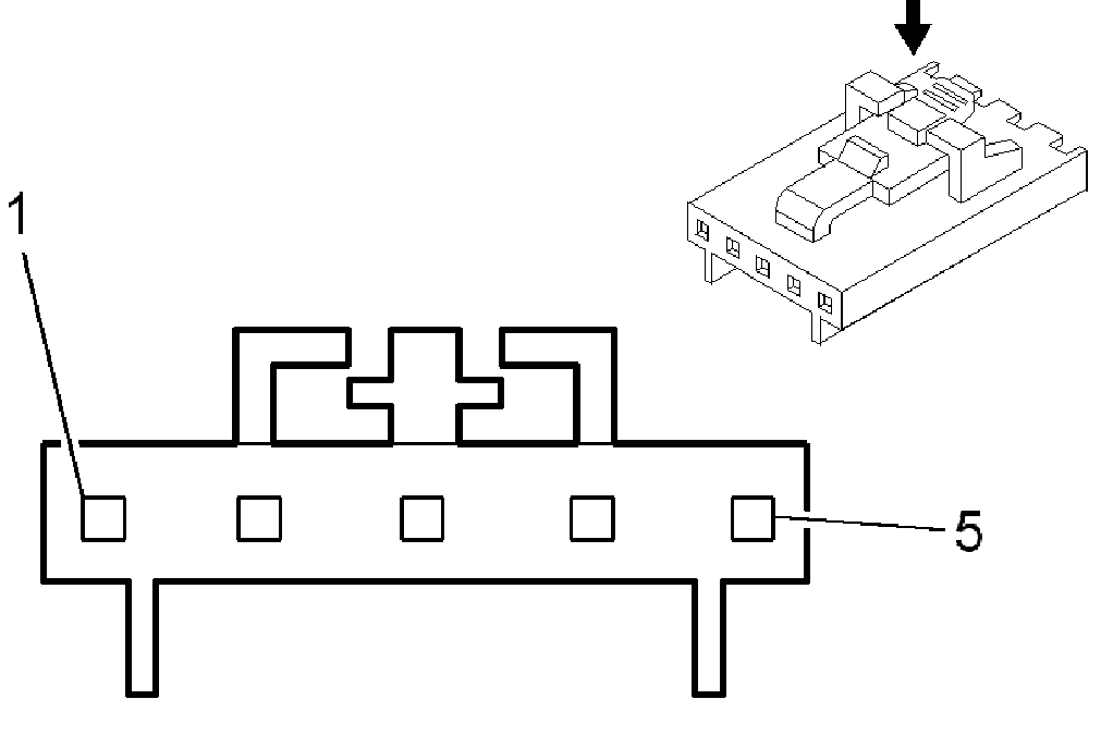

I think it is in the connector or wire to it.
You could install it, but there is programming to do that you cannot do.
If the technician was awake the day they taught "B" codes in the Tech2 class he should be able to tell exactly what is wrong with it. B codes don't always show on a standard OBD reader.
My money is on one of the wires got stressed when you were messing with the switch and pulled out of the contact.
Attached Thumbnails No Start: no steering wheel lock, key turns & pulls out, can shift gears, no turnover-theftpin.png   No Start: no steering wheel lock, key turns & pulls out, can shift gears, no turnover-theftplug.png   No Start: no steering wheel lock, key turns & pulls out, can shift gears, no turnover-theftcodes.png

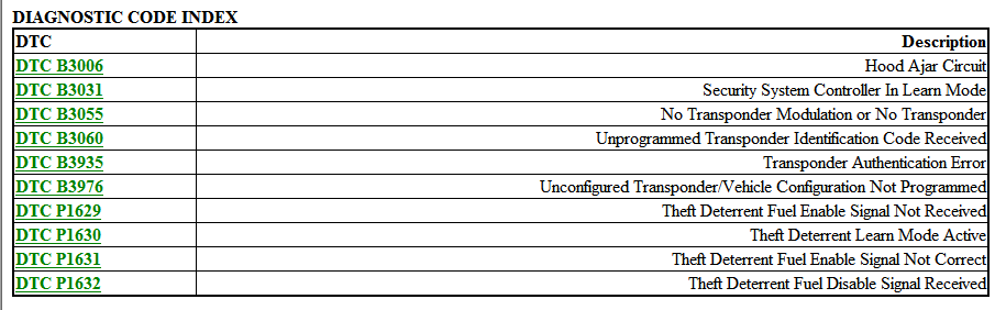

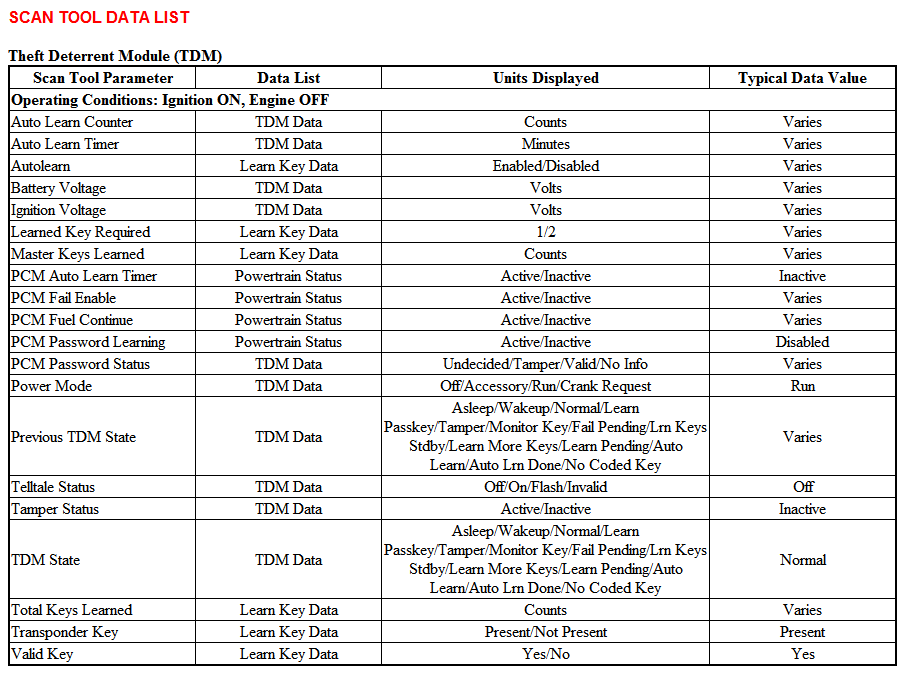

And how to use his Tech2 scanner:
Attached Thumbnails No Start: no steering wheel lock, key turns & pulls out, can shift gears, no turnover-scan.png

He said he checked the connector ends, no problems there. After checking wire connections, they are 'confident' the module under the key cylinder is the problem.
Thing is, I'm not quite so confident in THEM, because the original quote had part number 25910845, which is the BCM. I corrected them and pointed them to part number 25807440, which is the thing you pointed out in your pics, and that they pointed out to me in person.
Final quote now is $411 plus tax on the $150 TDM, not as bad but still stings..
