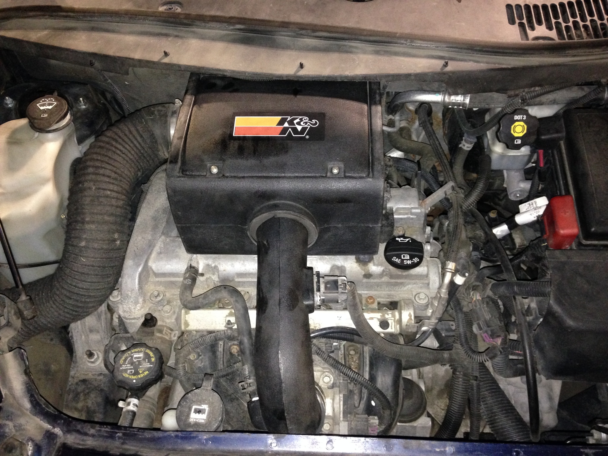

Those are stock plugs, replacement is suggested at 100,000 miles, also the coolant is recommended to be changed every 5 years, Dexcool only please, the green stuff can mess things up!
Have a look at the throttle body sometimes the oil is sucked out of the pvc hose from the valve cover

Check the rubber cap on the t-stat housing, they sometimes get a tiny hole and let steam out so you never notice a drip.

Also check the waterpump weep hole
