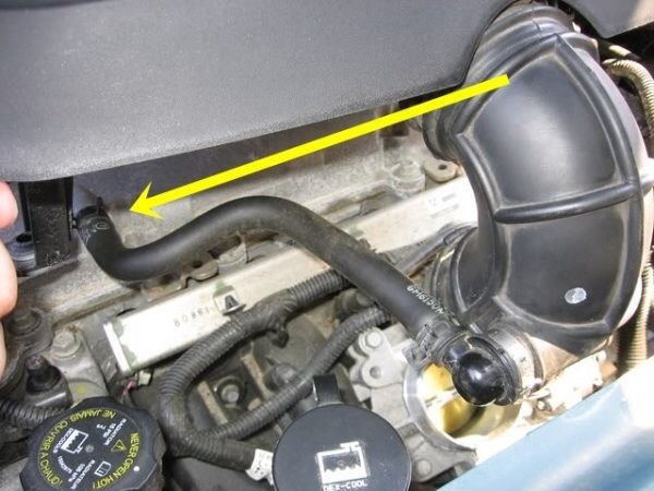

Thanks for posting those pictures, oldblue! I was woundering where that PCV hose was. It seems like it is pretty easy to check once the air filter is removed. Am I looking for oil deposits inside of the tube?

Posts: 40,082
Inside the tube , yes but it will go into the throttle body, so I always undo the one gear clamp there and lift off the elbow to check. No need to completely remove the OEM air filter box.
The clamp on the left is the throttle body end the PCV hose attaches to the shiny black fitting.
