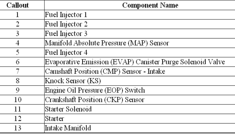

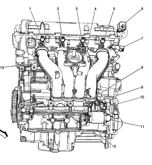

I did replace the oil pressure sensor, then the new starter went in. It seems like my leak has slowed down, but what is the sensor right behind the oil filter? It looks like a sensor connected to a hose that runs back into the steering assembly? I think my leak may be coming from there.
Old May 12, 2024 | 07:20 AM
Posts: 40,083
To the passenger side of the oil pressure sensor, would be a knock sensor.
Old May 12, 2024 | 08:30 AM
Posts: 26,533
Look here
