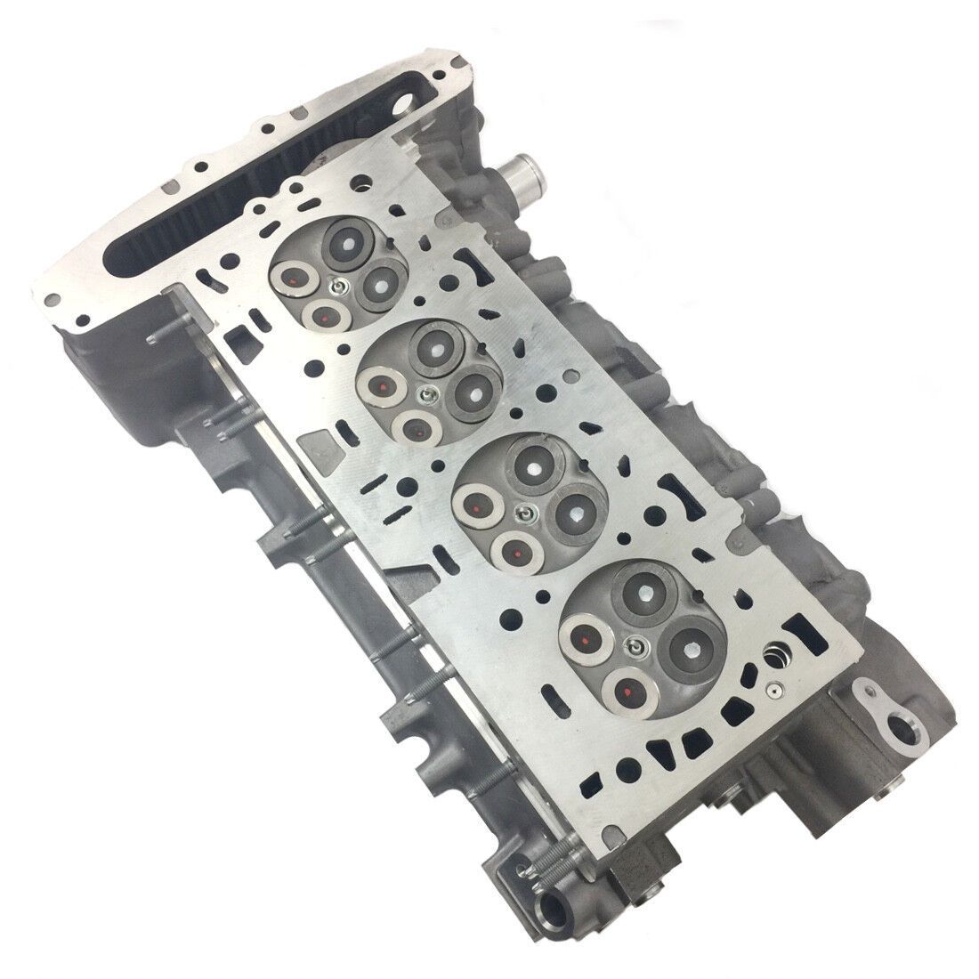

Thanks for the info. I'm thinking maybe it's a faulty head gasket or the deck on the block isn't level. I never checked if the deck was level before putting on the new head.

Hey all, sorry for reviving this thread again, but I have finally got around to trying to fix this issue. I haven't pulled the engine out yet, but can the 2.2 block decks be machined to a flat surface? The manual says to replace the engine if the deck is out of spec, but I was wondering if anyone here has machined the engine deck before.
