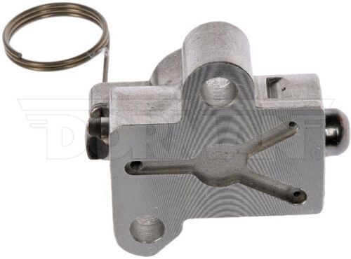

Somebody in the wayback did dissect the timing tensioners and posted pix.
I thought the balance tensioner was mechanical, I never looked at one.
I don't know how they could strip. The timing tensioner has lobes not teeth. Don't know why the balance tensioner would have enough action to.
"End of chain life" is why they seem to be malfunctioning. They can only extend so far.
Here is the backside of the balance tensioner, there are oil ports. The grenade pin thingy holds the piston until installation.
Found it
And this from the How-To library: https://www.chevyhhr.net/forums/how-...-rattle-46159/
