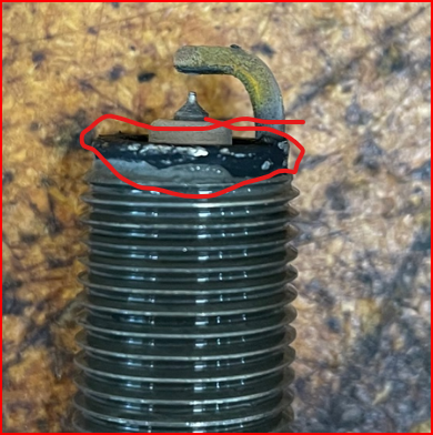

That looks like sludge on the plug. Is that just an illusion?
This qualifies zinc as a heavy metal.: https://www.ncbi.nlm.nih.gov/pmc/art...%20(32%2C%2045).
Maybe you are talking about the small spot of dirt on the end of the spark plug? I don't believe there was any sludge on them, they all looked pretty clean to me.

This is the sludge I meant.
I added some stuff to my previous post #30
I think it's just carbon on it, the lighting just makes it look like sludge. These also are the same spark plugs from when I was running rich about a year ago because I used aftermarket injectors. They were brand new when it was running rich. It wasn't really driven that much when it ran rich.

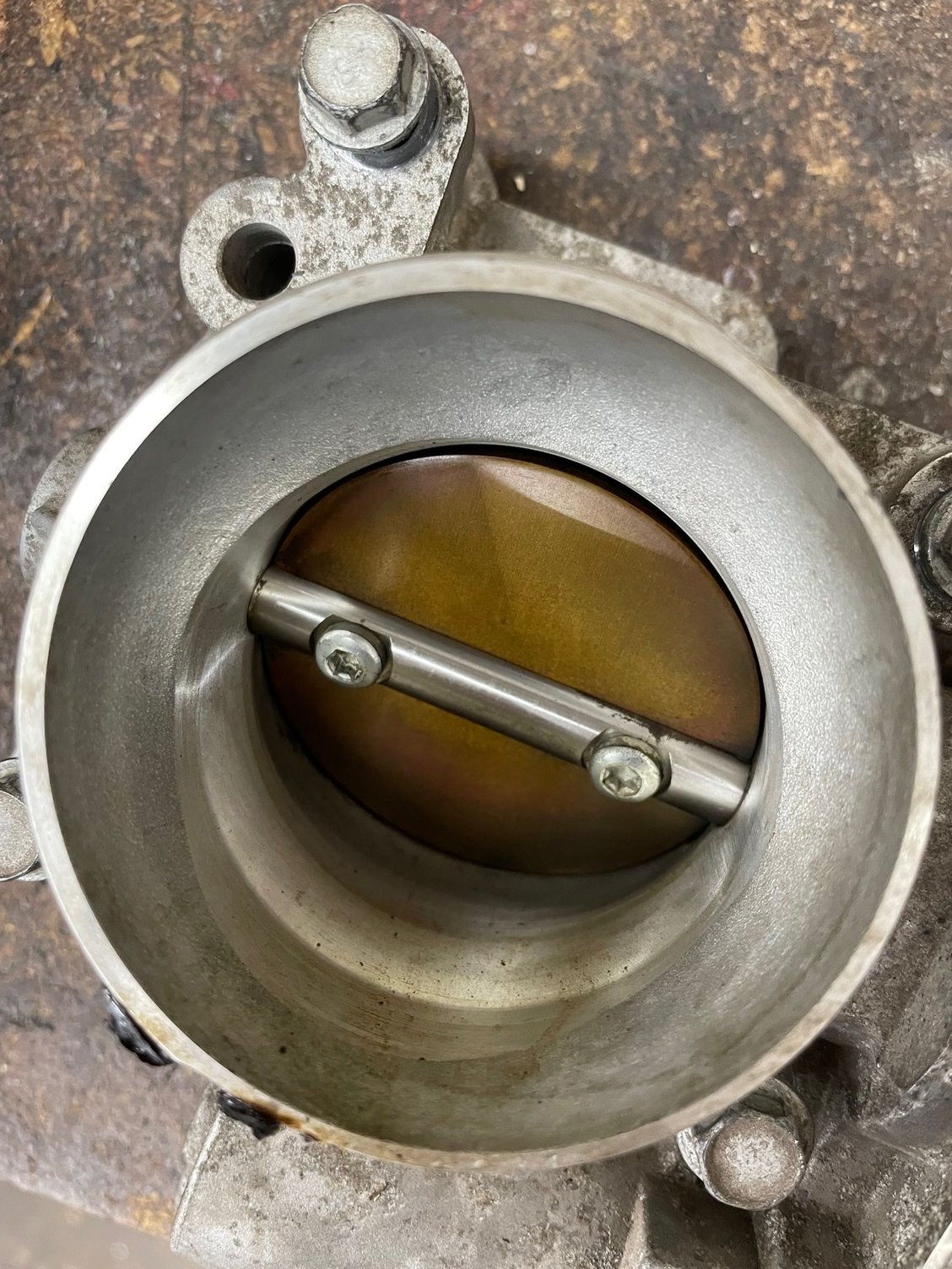

Okay, I got the time today to take the valve cover off, and I'm not sure if this is that bad, but it's very similar to how it looked when I put it back on a year ago. I lost about half a quart of oil in 2 days this week, around 40 miles driven
I took a picture of the PCV hose end at the valve cover and the intake elbow showing the oil along with the throttle body that I just cleaned a few weeks ago.
I have the valve cover soaking in dish soap and water right now, and hopefully, that will fix the issue.
