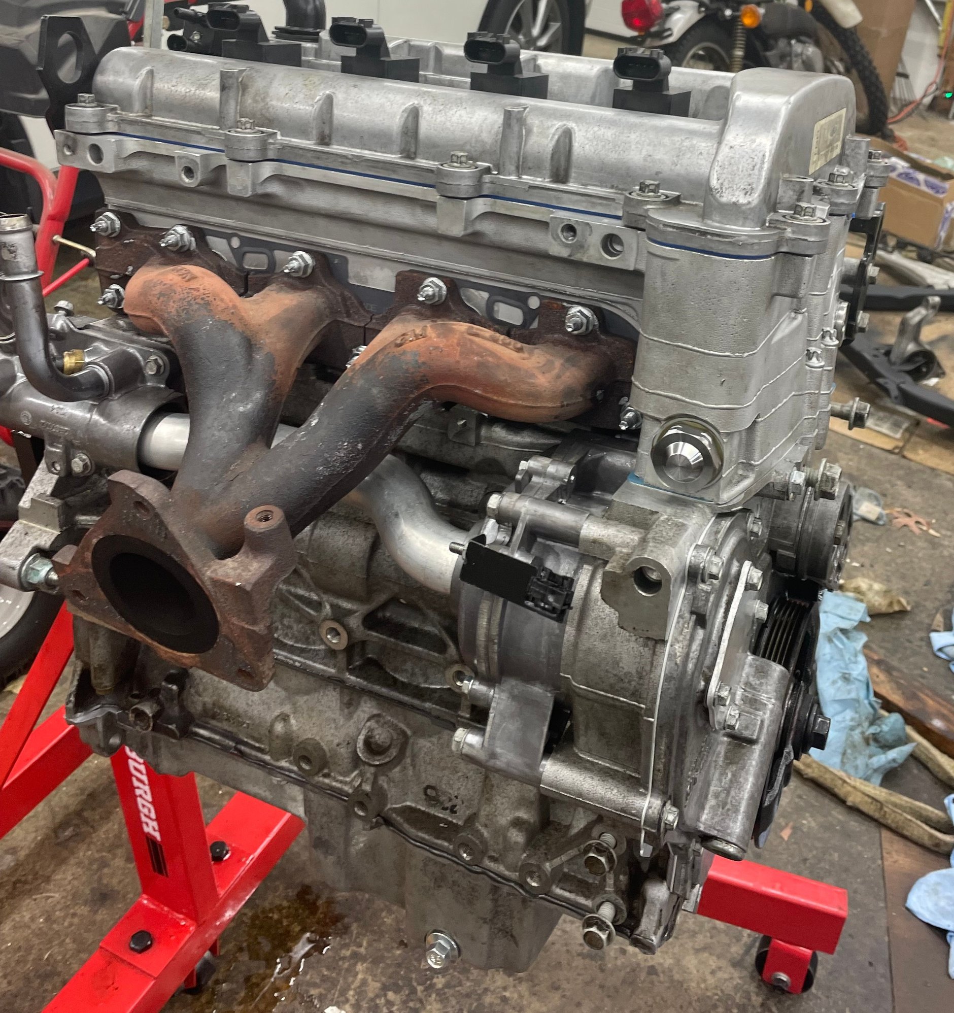

I was looking at the exhaust manifold again, and I noticed that the gasket didn't look right. It looks like I bought GM #12622668 rather than 12589453. I attached a picture from earlier when I installed the manifolds. Looks like the one I bought was for CA. Are they interchangeable, or could the tapping be an exhaust leak from this?

Change that exhaust gasket and yes you can reuse the front cover gasket. Double check that exhaust manifold for cracks, looks like one is there between 2 and 3 cylinders

That black on the manifold is either from a crack or extreme over heating.

What are the empty bolt holes and little square port holes that are visible on that manifold gasket ?
Wrong gasket ? Or right gasket upside down ?

I think the extra holes are for a different engine with EGR stuff.
