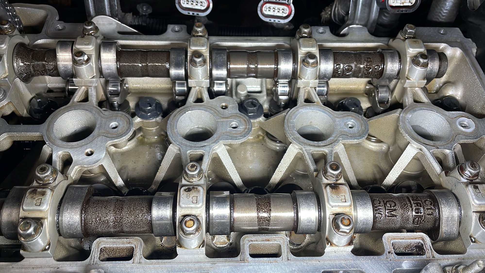

I pulled it off in that second video, but it still made the noise. I took off the valve cover last night, and everything looks good with the exception of possibly one rocker arm for the cylinder 3 exhaust. It looks like the bearings are visible in the picture, is this normal for them?
. I'm going to try using a stethoscope today to narrow down where the noise is coming from.
