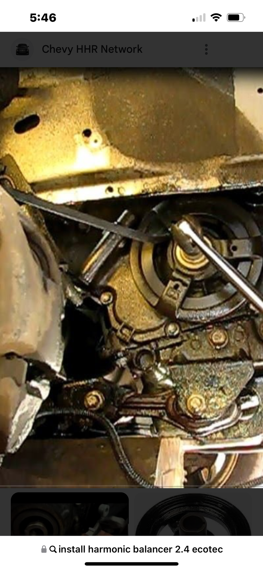

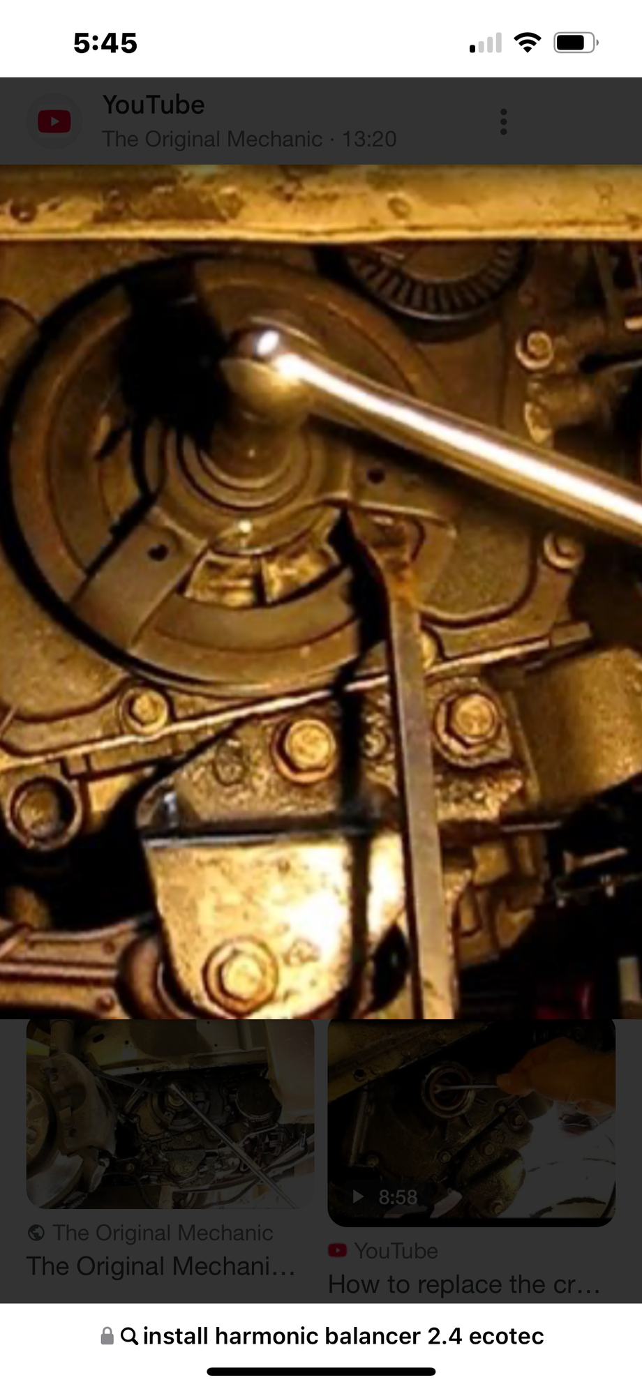

A pry bar held between the harmonic balancer and front engine cover
I’m going to suggest just the pry bar to hold the crank from turning, you shouldn’t need the socket and breaker bar , these photos are from removing and replacing the harmonic balancer
