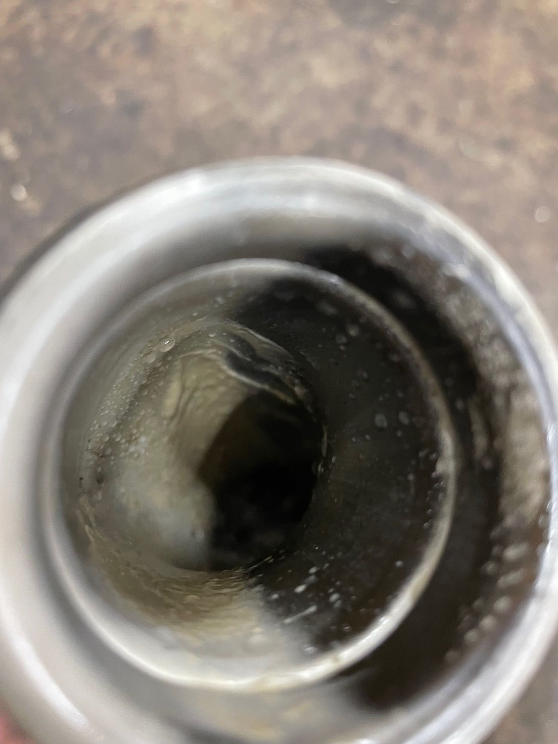

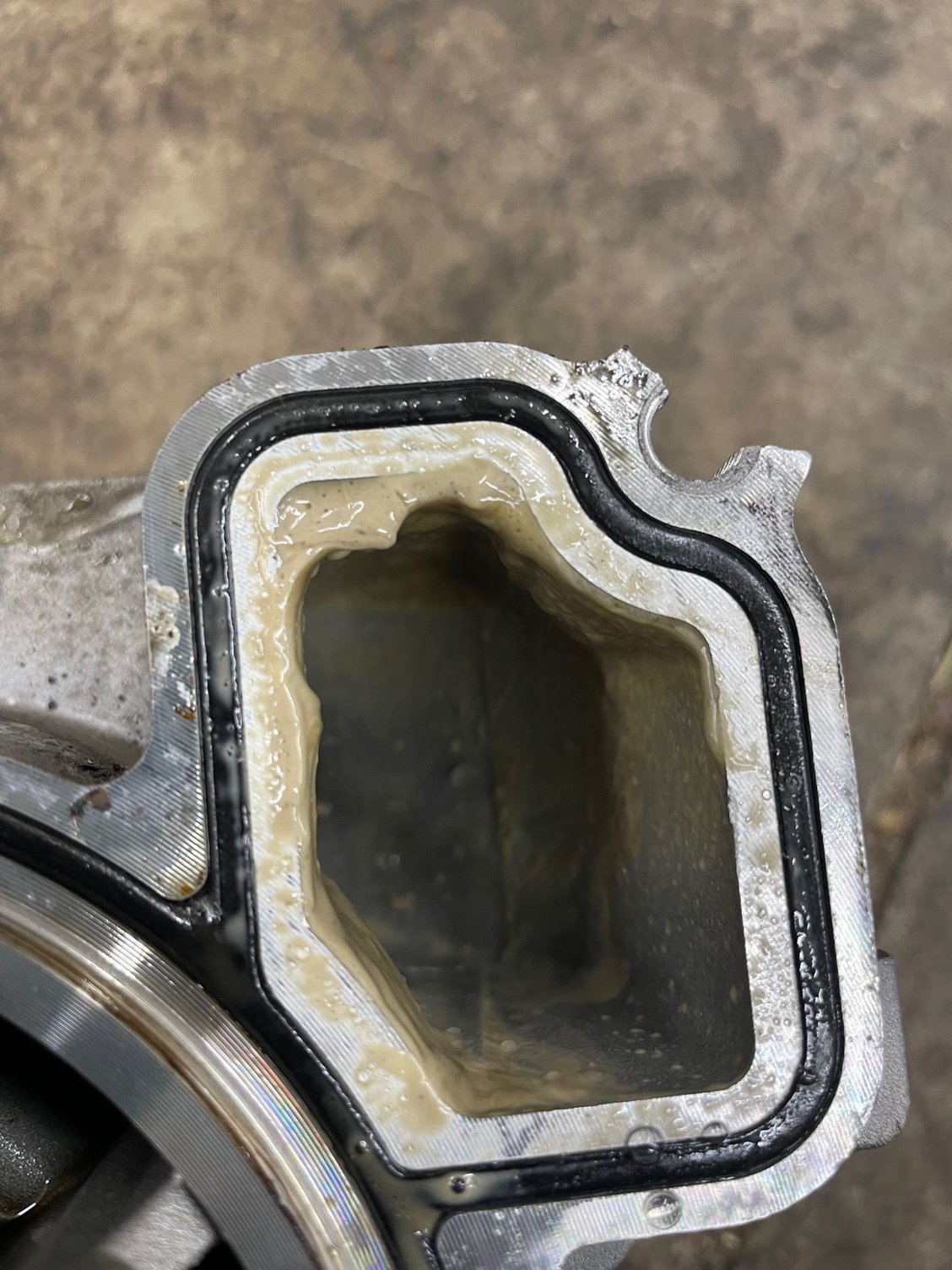

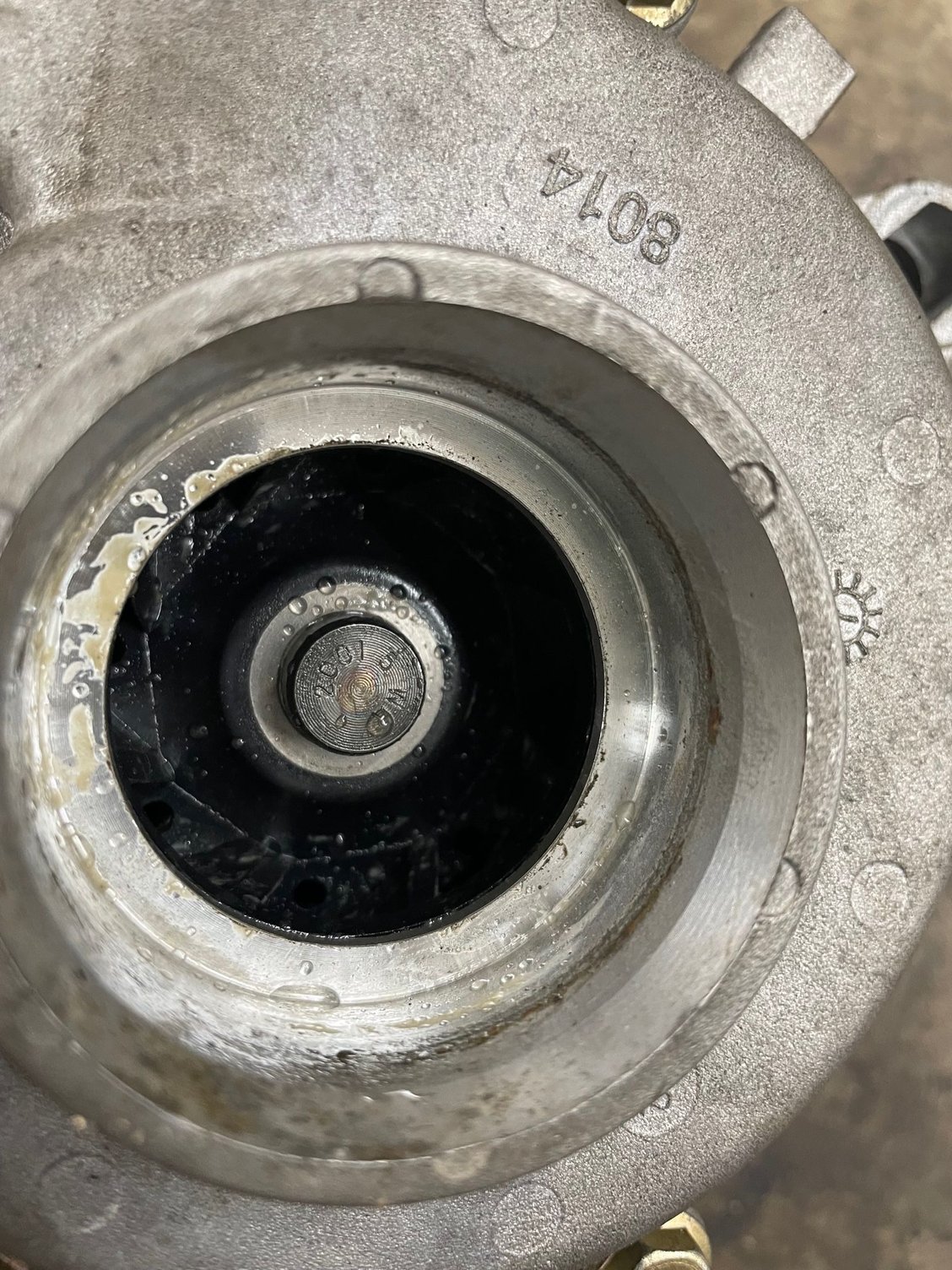

Alright, got the water pump off today to find that it looks okay to me. One thing that looked a little weird was the coolant tube that goes into the water pump. It is dark on the bottom part.
The sprocket holder was definitely handy and saved me from dropping a few bolts into the timing chain area.
Is there anything more I can do to determine if it's alright?\
Here's some pictures of it:

I just noticed looking at these pictures that I broke a part of it... great... missed the bolt that I was staring at the entire time and removed the one below it instead..

Install the new pump, new transfer pipe Orings and see
