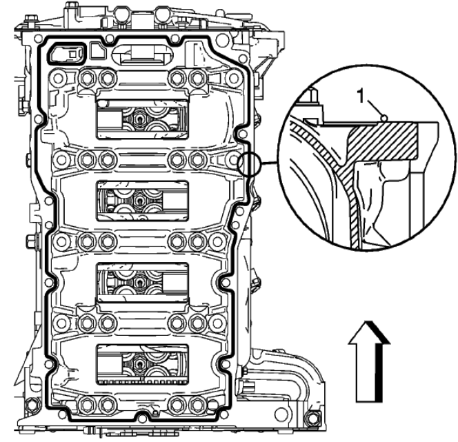

This port here, it’s the oil pickup tube to the oil pump in the front engine cover
Oil pan bolt torque sequence , torque to 18 ft lbs.
