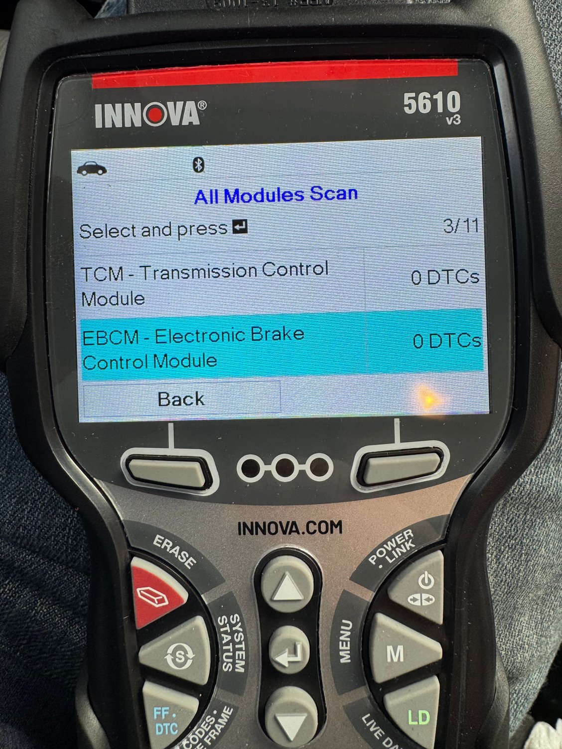

Hot damn!!! I went to the junkyard again and bought two more ABS modules ($15 each), one of which came from a wrecked HHR. Installed the one from the wrecked HHR, and as you can see, no more ABS/Brake/ESC lights are on and no codes are present!!! Woo hoo!! And guess what!? I don't even get the VIN mismatch so I'm not sure I will need to program it. :) Update Edit: I did actually have to have the ABS module programmed. I was also able to repair the ABS module wiring harness connector with one that I got from the junkyard. Now, we still have a lot of snow so I wasn't able to drive it around for a good test, but this is the first time I've started without the C0550 error code. Thanks to you all for your help!!! I have a few things I'm going to tidy up before I'm done. For example, there is a vibration that annoys me when it is in gear and stopped, don't really notice it when in Park. And there is a rattle coming from the muffler area also when in gear, but not usually noticeable in park. Getting close. Thanks again!!

Another update: Turns out the ABS module did need programming since the VIN mismatch code came back upon next ignition cycle. I thought it was gone since it cleared and stayed cleared while driving, but came back next time I drove it. Called my local Chevy dealer and they had a guy who has been working on Chevy vehicles for around 20 years and he knew how to program my the old 2010 ABS module. :) There was another service guy who didn't know how to do it so it must be dependent on the mechanic's experience. I had the ABS module programmed and an alignment done; all work completed successfully which means the ABS module is good and all my suspension work I did seemed to be done correctly. :)
