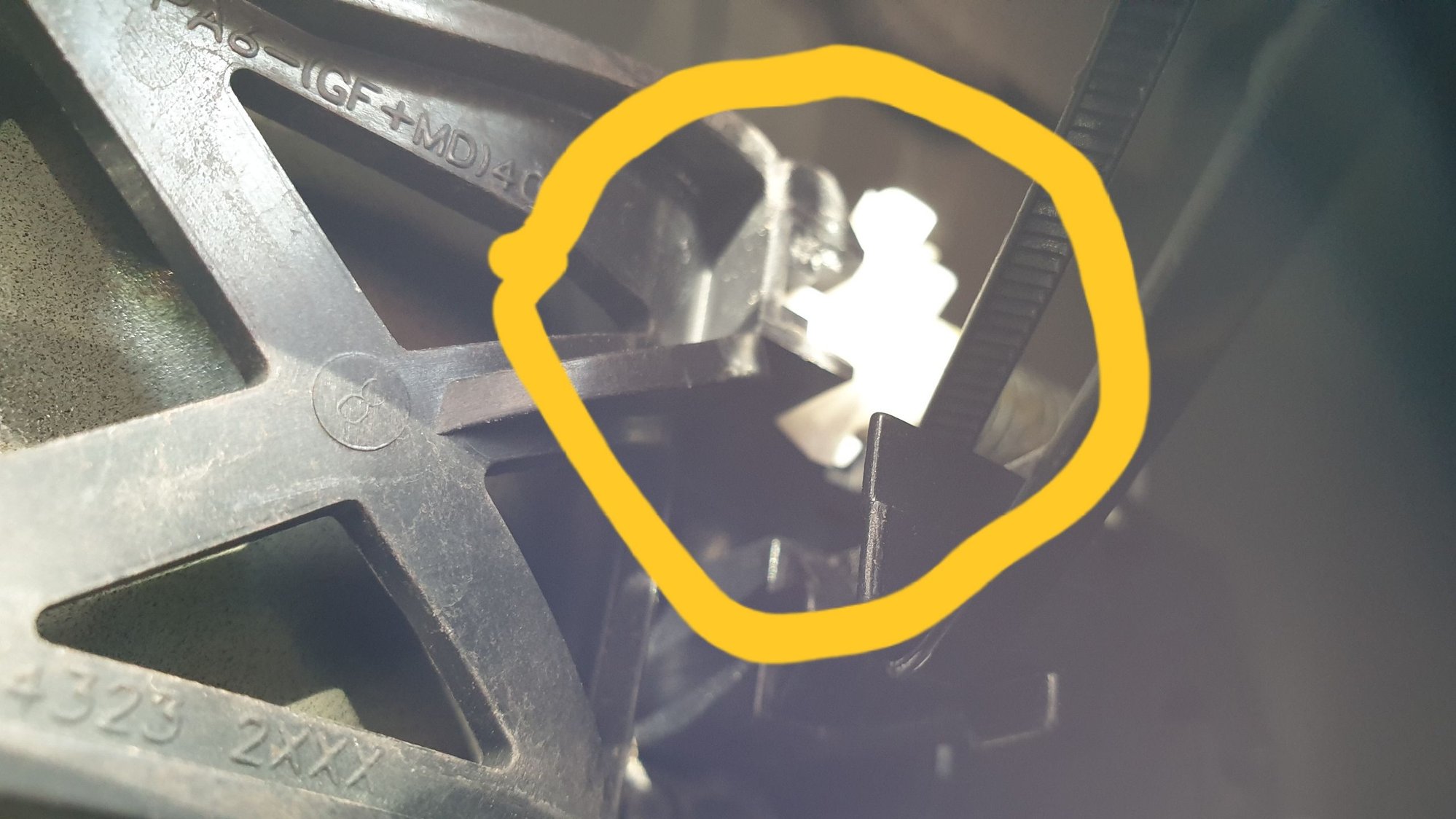

What's this part called ?
Was replacing the outside door handle, something broke on the inside. Rod is no longer attached to the doorhandle mechanism. Which part should I order (I live in the Netherlands)

it's not the actuator. There is a small rod attached to this part. The part is connected with the outside doorhandle. The white plastic retainer broke. The rod hangs loose and the outside door handle no longer works

actually, I thinks it's #30 forgot to say it's right rear door

I’ve replace part number 30 in the right rear door, pretty easy to do

Just replace and attach the rod to the white plastic part I guess

Most auto parts places have a brand called "Help"... They may have a package of misc. door hardware clips and one of those may work but you need to be able to judge that by eye looking through the blister-pack. They don't list what cars they fit.... Just that they are "door habdle clips" or something like that. The "Help" brand has all kinds of misc bits and pieces.... Grommets, special bolts, retainer clips, etc. etc. It's worth looking anyways...
