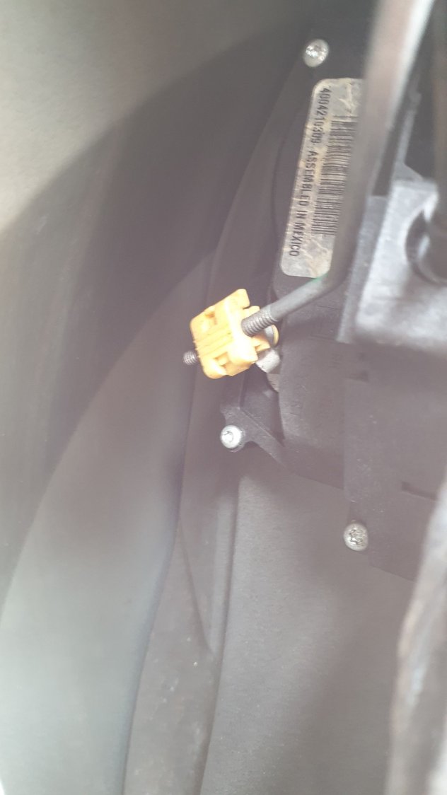

Originally Posted by 68greaser
The white plastic retainer broke. The rod hangs loose and the outside door handle no longer works
#32 is the white piece, #29 is the clip that holds it into part #30.

The white plastic piece broke from the base

Question about the yellow rod fastener, how do you get the rod out ???

Looking at the yellow clip it appears to have a release tab on the top and it should open up like a book.
Never really looked at one but by the picture that's what I see.

Or maybe it just twists off. The rod appears to be threaded all the way to the end.

Always afraid to break something if it's made out of plastic

Problem fixed, easy job. Decided to paint my oem door handles, aftermarket pieces sucks
