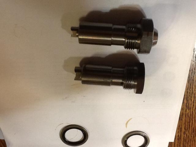

The new tensioner is oil and spring loaded. When you install the updated tensioner it still has to be released to properly tension the timing chain before starting the car. Here are some pictures of the old and New tensioner. You can see that the new one still has the spring loaded parts that get released by taping with the valve cover removed.

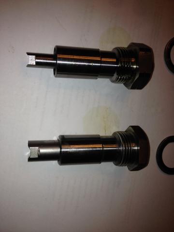

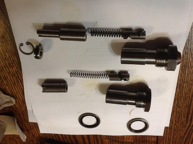

Sorry my pic is upside down. The new tensioner has a snap ring to hold the assembly together. Here is a pic with both of them loaded and then released.

I do know that when I installed mine i removed the valve cover and tripped the tensioner like it states in the manual. it trips and pretensions the chain with very little effort. so little infact that I didnt think it was releasing so i removed it and it shot out of the block under spring tension. Thats why I had to take it apart to reset it.
