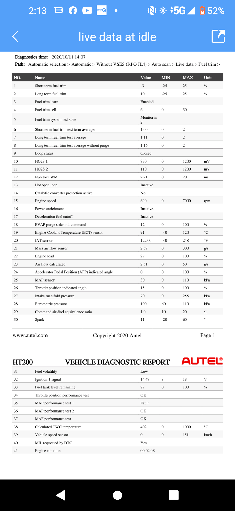

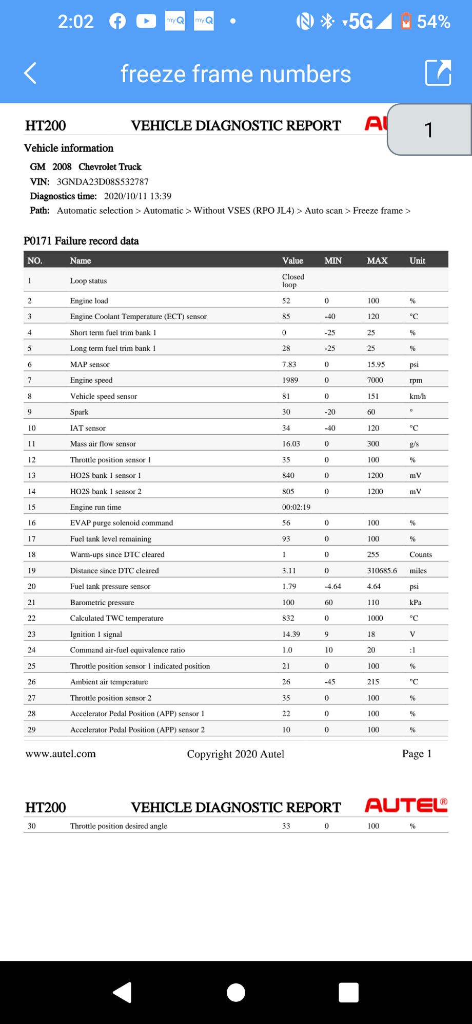

Not sure if this is what I need to look at? But I figured I would post these numbers from my scan tool while I figure out how to test the fuel pressure. I just now found a tester that I bought from the parts store.
