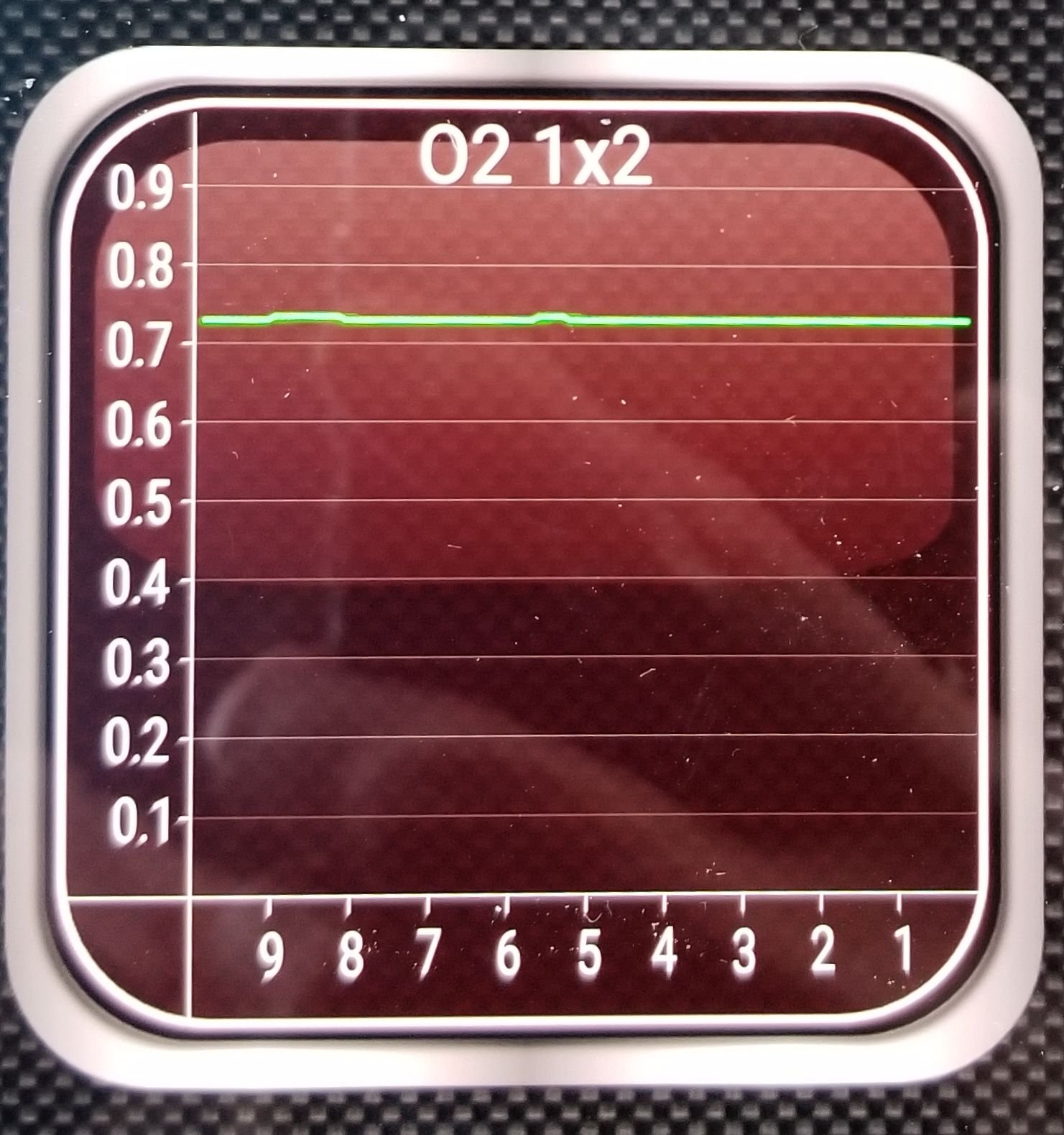

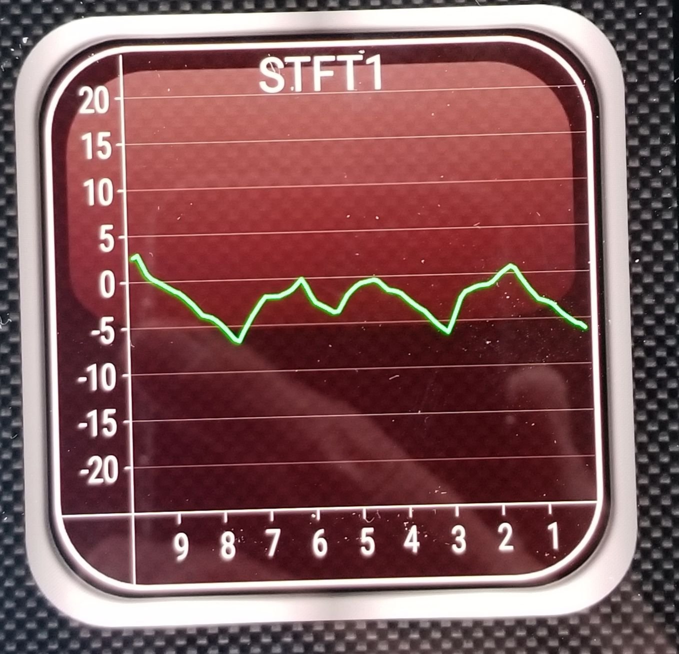

So I asked my shop to put in a plastic kit to fix the fuel line but they just patched the leak instead. Ordinarily I'd be fine with that but I was hoping to eliminate a possible leaky vapor line as a problem source. I'm still I'm still getting hard start when cold, smelling fuel in exhaust, obviously very rich, seems fine once warm. Tried clearing the only code, P0172, comes back, and...
NEW issue, fairly loud clacking noise, 2-3 per second, for about 5-10 seconds on startup, hot or cold. Noise seems to emanate from inside dash, and also same or similar clack each time I press the brake pedal. That also stops after a similar amount of time. !??? (What's the best way to share a video with the noises?)
1st O2 sensor voltage bounces all over the place, even after warmup. The #2 is steady. Short term fuel trim (STFT1,) I have no idea how to interpret. I assume the ecu is trying to compensate for a rich mix.
Thinking I need to get a fuel pressure gage.

#1 O2 sensor is supposed to jump up and down, that is the short term fuel trim mechanism. The #2 O2 sensor is supposed to be rock steady. You need to get a fuel pressure gauge, the OBD does not report it.
Kinda looks like a leaky injector. Clacking when hitting brake pedal usually stems from weak battery.
