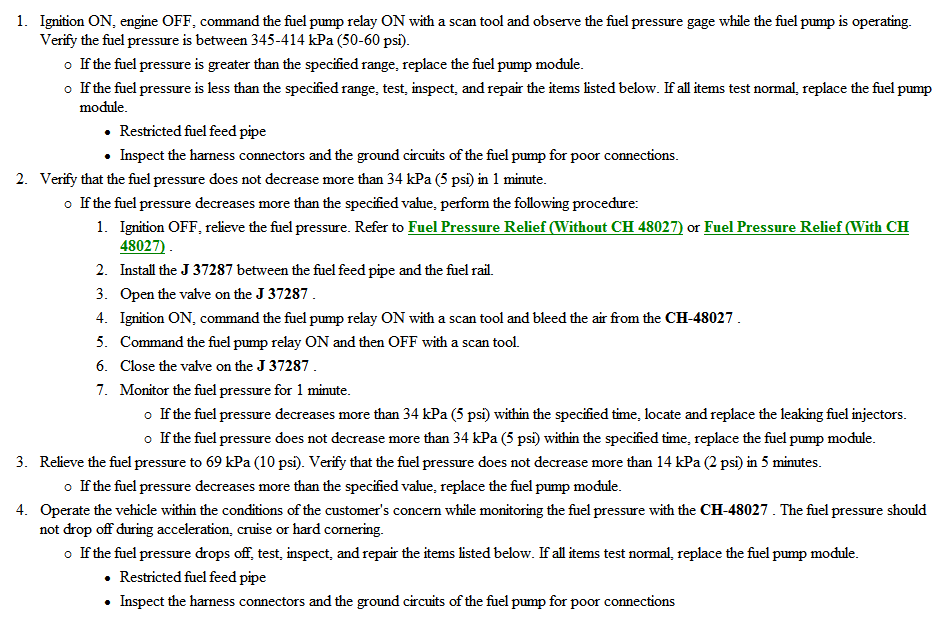

Here's the fuel pressure test. Let me know your thoughts guys.
Car had been driven for a 25 min ride home. Then sat in the drveway for 1 hour before testing.
Key ON no Start= 55psi
Key ON no Start= Fuel pressure begins to drop steadily. After 15min of Key On no start Fuel Pressure at 30psi
Key On RUNNING= 60psi (car stumbled a little on startup, then smoothed out. No variance in fuel pressure at gauge)
Key OFF for 10 min after running= 55 psi
Key OFF for 15 min after running= 51 psi
Let me know wht you think before I start tearing things apart on Friday morning.

Originally Posted by donbrew
Keep in mind the pump only runs for 2 seconds with engine off.
I do not have a scan tool that will activate the fuel pump. Nor the specialty tools mentioned here.
But based on this information here, and the test info I've provided... Do you agree that the fuel pump is within proper operating specs?
Old Jan 10, 2019 | 09:31 AM
  #85
Posts: 26,485
Turning it on with the key is close enough, the special tool is the gauge.
step 1 passed
step 2 start at 7 monitor pressure for 1 minute
if it decreases more than 5 PSI, it is an injector
if it does not decrease more than 5 PSI replace the pump.
step 3 unknown
step 4 unknown
Seems to point to pump, still could be a
step 1 passed
step 3 unknown
step 4 unknown
Thanks for breaking that down. I've planned to work on this Friday morning. So tonight, I'll get it in the garage, and check it from 7psi for dropping in the specified timeline.
step 1 passed
step 3 unknown
step 4 unknown
I can tell your 100% right now, that with the Key On engine off that the pressure drops more than 5psi in one minute after initial prime. You can watch it drop quickly.
I meant part 7 of step 2 not 7 PSI.
Gotcha.
Well, it decreases immediately and quickly with Key On Engine Off. Indicating Fuel Injector issue.
