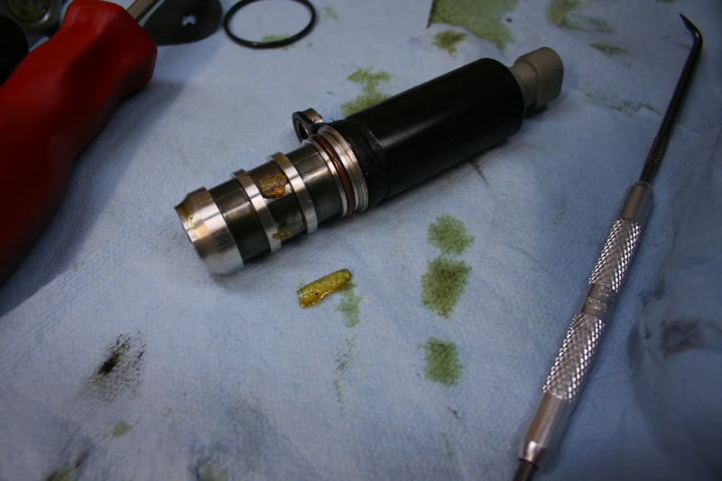

Fresh and correct oil? Pull the valve out and make sure the screens aren't plugged. The GM part numbers are 12628347 (intake) and 12628348 (exhaust).
This is what I found on mine:
There were no codes or noticeable problems with mine, but it's something to check out.
The part you linked to is the sensor, not the solenoid valve. For the PO300 start by changing the plugs with new AC's gapped at .032''. The camshaft solenoid could potentially cause misfires as well if it's not working right.
