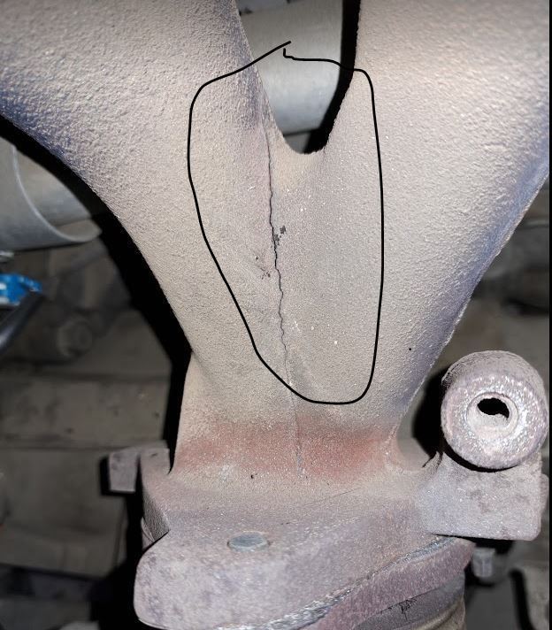

Have a look to double check the exhaust manifold for cracks
You will have to remove the heat shield

That looks familiar... for when I swapped the engine my HHR had that same exact crack... the new to me cobalt manifold did not... so I swapped it then. :)
