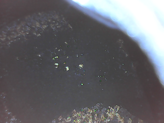

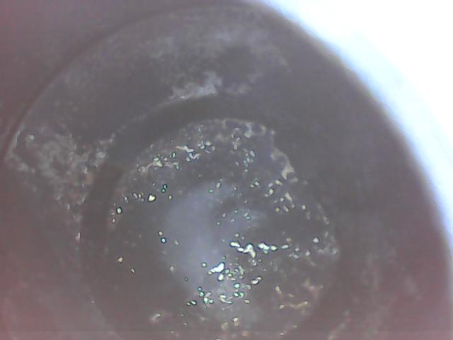

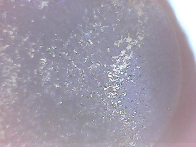

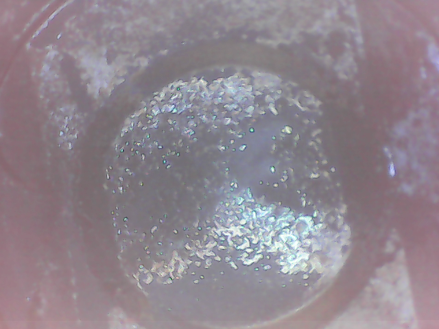

Here's the best pictures I could get of the cylinders, not very useful, I'm afraid.
Attached Thumbnails P0302 low compression 2011 / 120k-1.bmp   P0302 low compression 2011 / 120k-2.bmp   P0302 low compression 2011 / 120k-3.bmp   P0302 low compression 2011 / 120k-4.bmp
