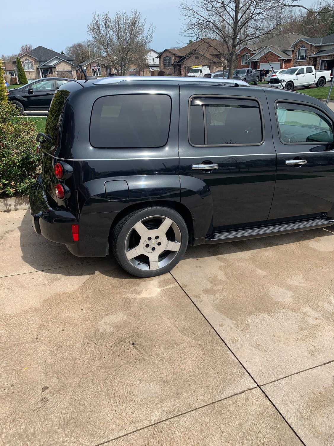

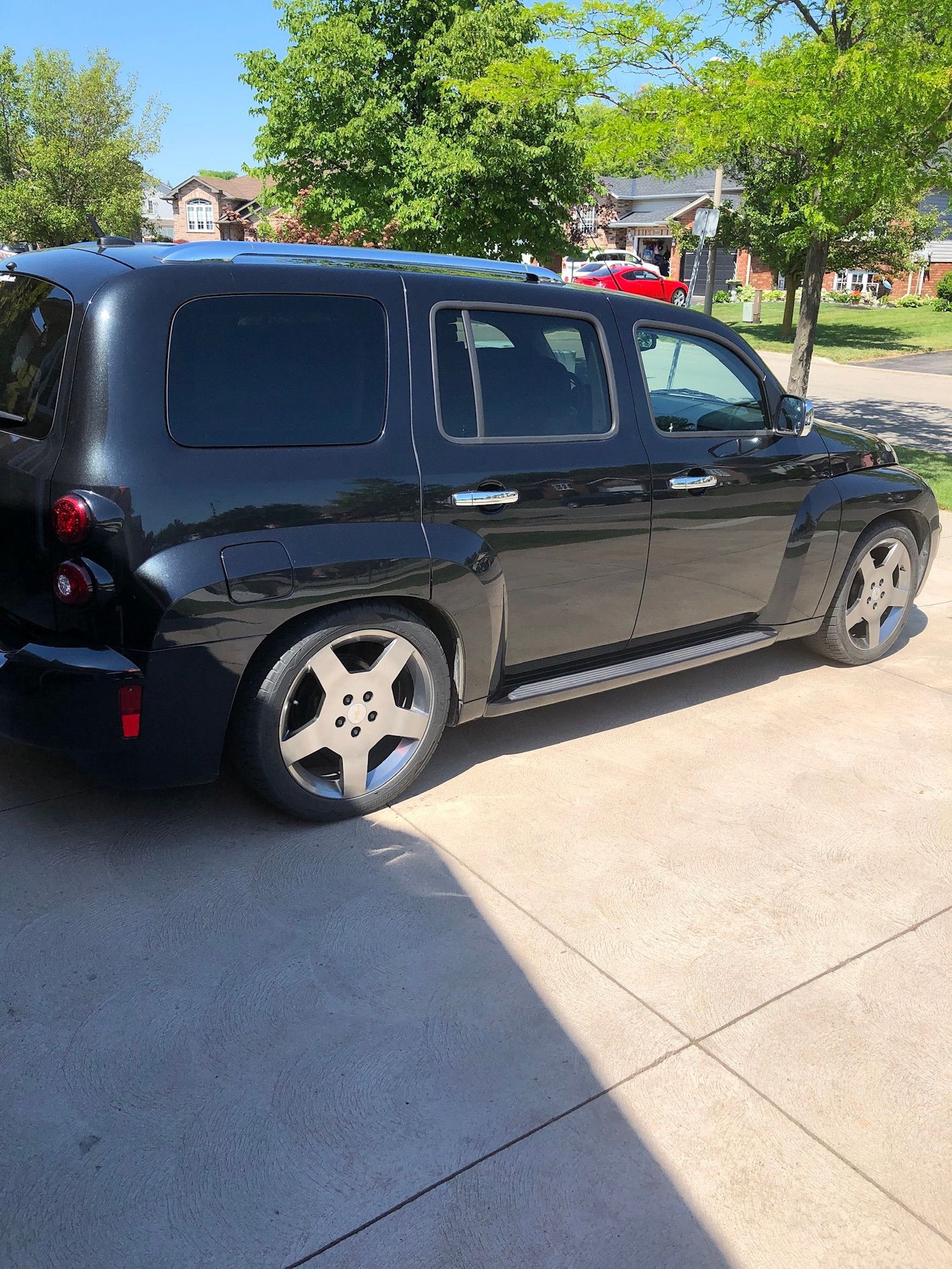

Rust paint bubble removed, sanded primer Ed and painted
Hard to see, small paint bubble from rust just above the right rear tire.
