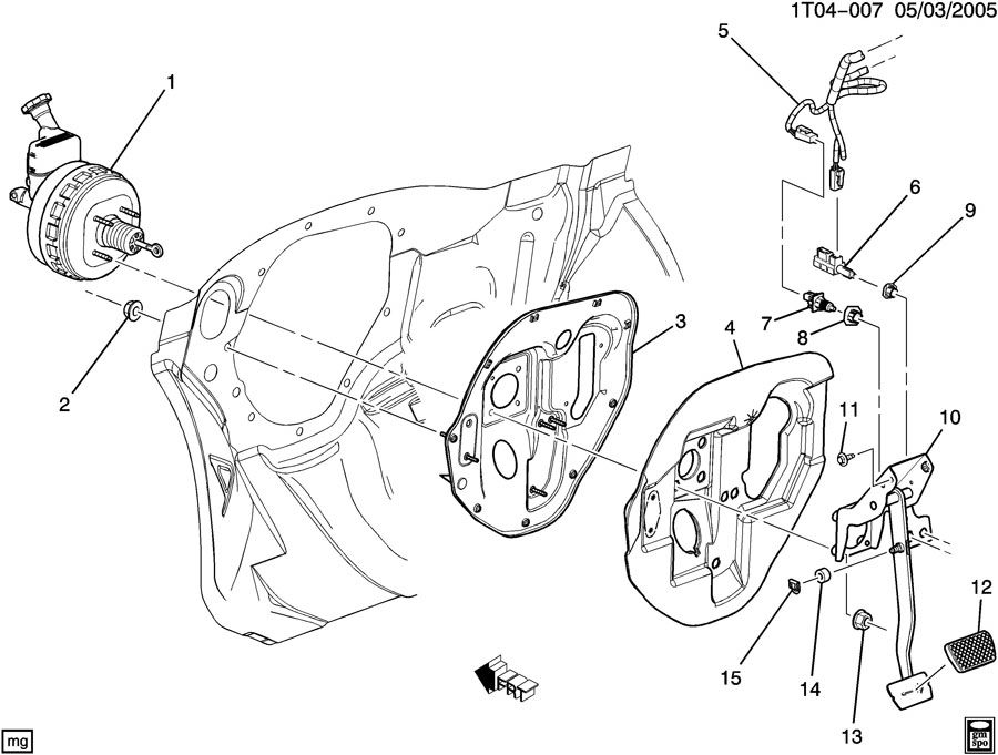

Check the switches on the brake pedal. #6 and #7, although I believe #6 is the one that affects the shifter interlock. Are they plugged in securely? Do the brake lights come on when the switch is activated?
Guys, can this switch be bypassed, as a test, or what is a good testing procedure?
