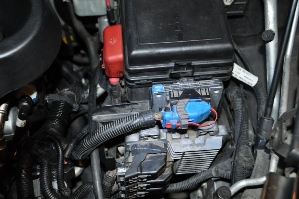

There are two holes on PN 25803946 near the bottom that are unused in the picture. I know that the cover that goes over this area is PN 15828134 and I have that part. Is there anything that is supposed to go in the lower area using these holes to avoid water coming up to these electrical components?

weep holes

I am not doubting you, but I am talking about the two holes below the ECM area. They don't seem to be enclosed when the cover is on so I do not understand how a weep hole would be needed here.

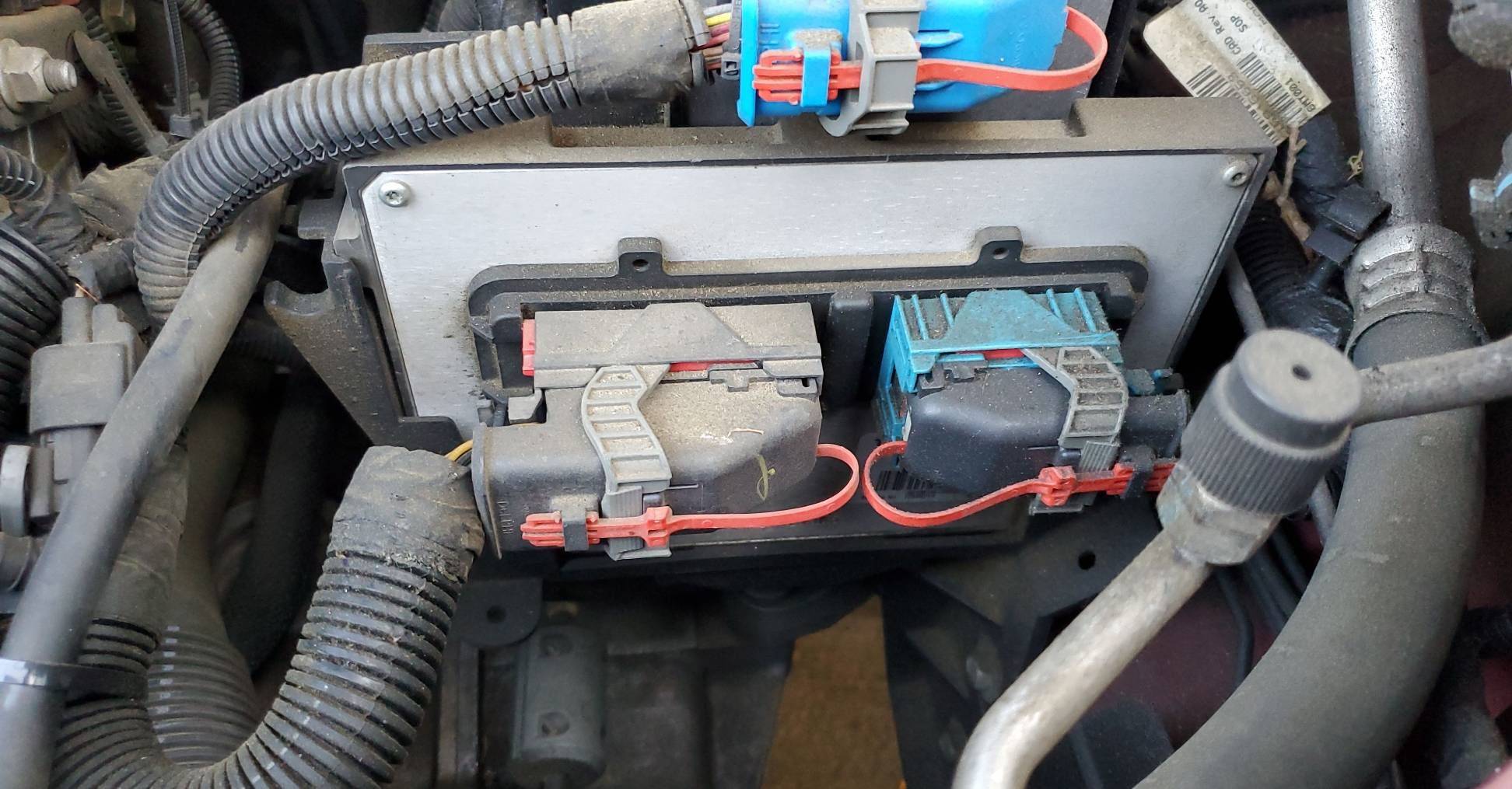

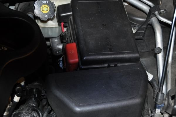

The TCM and ECM live in this bracket,
Under this cover, nothing below or underneath, just that Darth Vader helmet like plastic cover.

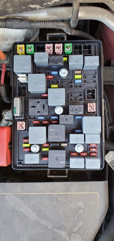

Check the fuse marked "EXH".

Thank you, I believe the codes are P0131 and P0420. Is the fuse you are talking about in this picture?

There should be a map of the fuse block, inside the lid, and also in your owner manual. If you need a manual, see the link in donbrew's signature.
