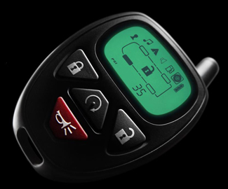

Does the antenna come with the remote? IF not do you have the part#.
Old May 16, 2009 | 10:01 AM
ChevyMgr's Avatar
Joined: 11-23-2007
Posts: 8,210
From: Texas
It all comes in a kit.
Remote Start
Part Number: 19157234
Your Price $150.00
With Installation $286.00
2-Way Advanced Remote Start (w/ RPO Code AP3)
2-way technology and a convenient display screen shows the vehicles current status (locked or remote-start engaged, for instance) and critical vehicle data, including tire air pressure, fuel level, odometer and theft alarm status. This fob offers greater operating range then the factory keyless entry system, and can control a second, ARSS-equipped vehicle.
Not for use on Panel LS and Panel LT models.
Remote start package only includes one remote key fob.

The kit includes 1 transmitter, 1 RCDLR, 1 antenna and a manual. For 2007 vehicles the antenna is installed behind the right rear quarter trim panel and for 2008 it is adhered to the right rear quarter glass.
