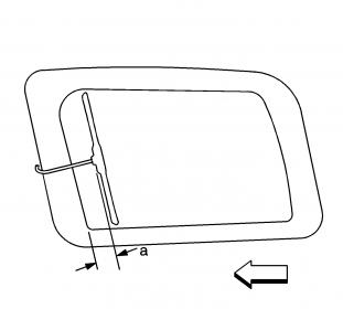

Apply Glass Adhesion Promoter GM P/N 12378555 (Canadian P/N 88901239) to the rear quarter window in the area where you will install the antenna. Follow the Glass Adhesion Promoter instructions on the product label. Use a = 90 mm (3 9/16 in).
Important:
• Position the antenna according to the figure provided.
• Do not touch the adhesive pad on the antenna.
Remove the protective film from the adhesive pad on the antenna.
Align the antenna to the glass blackout area according to the figure, using a = 90 mm (3 9/16 in).
Press firmly all along the adhesive pad of the antenna, including all four corners of the adhesive pad, in order to ensure proper adhesion to the glass.
Hold pressure on the antenna for 10-30 seconds.
Ensure that no gaps occur between the antenna adhesive pad and the glass.

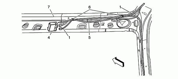

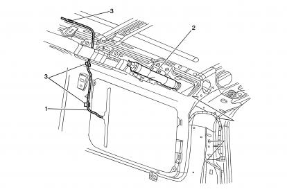

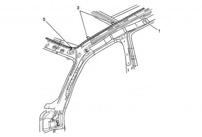

• Do not bend the roof side rail inflatable restraint module brackets during installation of the antenna.
• Route the antenna cable above the roof side rail inflatable restraint module along the passenger side of the vehicle.
Route the antenna cable (1) behind the roof side rail inflatable restraint module bracket (2) and secure to the roof along the passenger side of the vehicle with five adhesive wire-wraps (3).
Secure the antenna cable (1) to the main body wiring harness (5) at the front header (7) with two tie wraps (6).
Connect the antenna (1) to the 2-Way RCDLR (4).
Reassemble. Refer to Remote Control Door Lock Receiver Replacement.
