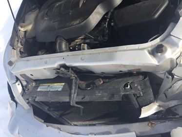

i just drain the coolant, remove the upper and lower rad hoses ( access them from the side behind the plastic deflectors)
the carefully remove the retainer clips from the transmission cooler kits and gently wiggle them out of the fittings.
I then remove the two rad retaining brackets and gently lift the rad out .
The clips and transmission lines, I use a dental pic tool I got at HF, slide back the plastic cover, #6 then remove the clip #7 in the photo
Here’s a photo of the side plastic deflectors
There’s a bracket on the passenger side. And oh yeah you need to remove the hood latch assembly
