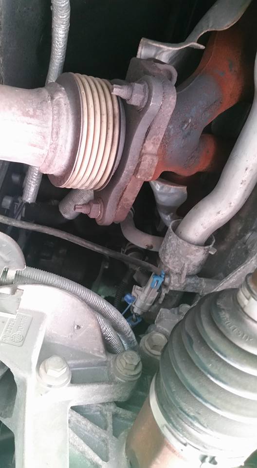

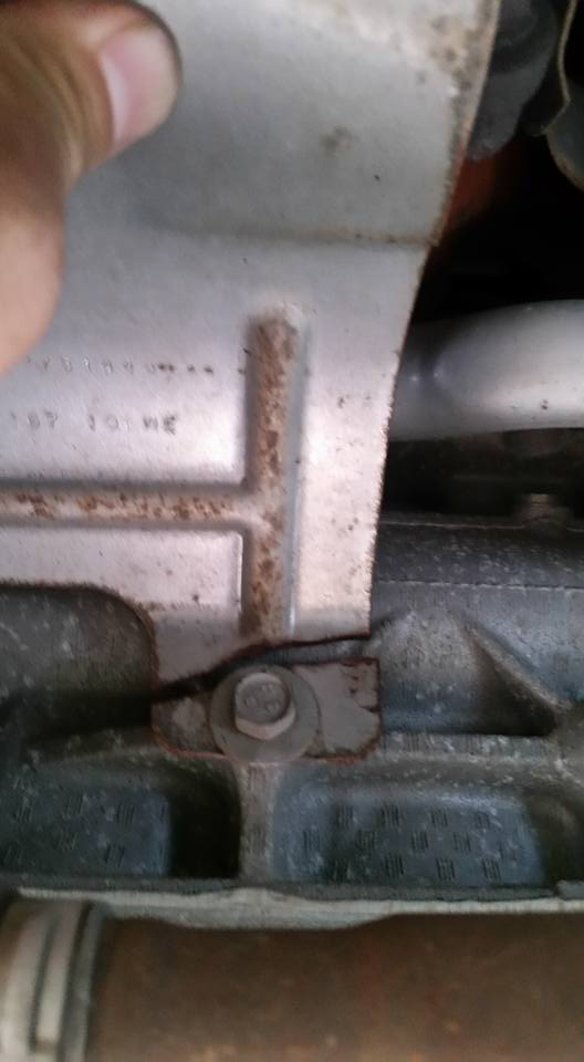

rattle noise
so i have had this rattleing noise going on for awhile so i started searching and found this. its the shield inder the flex pipe. getting to the one little bolt was a PITA. it is alot heavier than the rest of the heat shields and dont know if its a guard for the cv shaft incase it would fail or what? i was wondering if i could just leave it off?

Is this the part? #1
Or this? #2
Same part, GM part # 15781449 SHIELD. Front Wheel Drive Axle Shaft.
SHIELD,FRT WHL DRV SHF CV JT BOOT.
Old Jul 15, 2017 | 07:45 AM
Posts: 26,538
It is fairly important.
Those are both the same,just different views.
Old Jul 15, 2017 | 07:59 AM
Posts: 40,091
Yes just replace the broken part, it protects the cv joint boot from exhaust heat.
